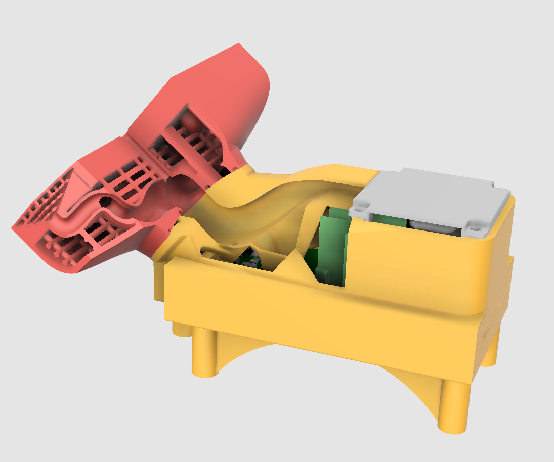

Printed parts:
All of these files are available for download. If you'd like to join FATHOM's A360 hub and contribute, please send me an email.
- Boot: Printed in Nylon 12 (FDM). ~37 hr build
- Tongue: Printed in Nylon 12 (FDM). ~46 hr build
- Sole: This is a multi-material assembly printed on a Connex3. The sole was printed at Shore 60 with a fully rigid frame. ~6 hr build.
- Electronics cover. Printed in a rigid vero (polyjet). ~ 3 hr build
- Speaker cover. Printed in a rigid vero (polyjet). ~30 minute build total.
- Straps: Five different straps. Printed in Nylon 12. ~2 hr build each, ~10 hrs total
- Latches, ratchets and pins: Five of each, 25 total parts. Printed in Nylon 12 (FDM). ~10 hrs total
Total printing time was about 112 hours -- almost 5 days.

After printing and cleaning the parts, it should be fairly obvious how they fit together. The wiring diagram is attached. There's quite a bit of wiring, it's tedious but not difficult.
