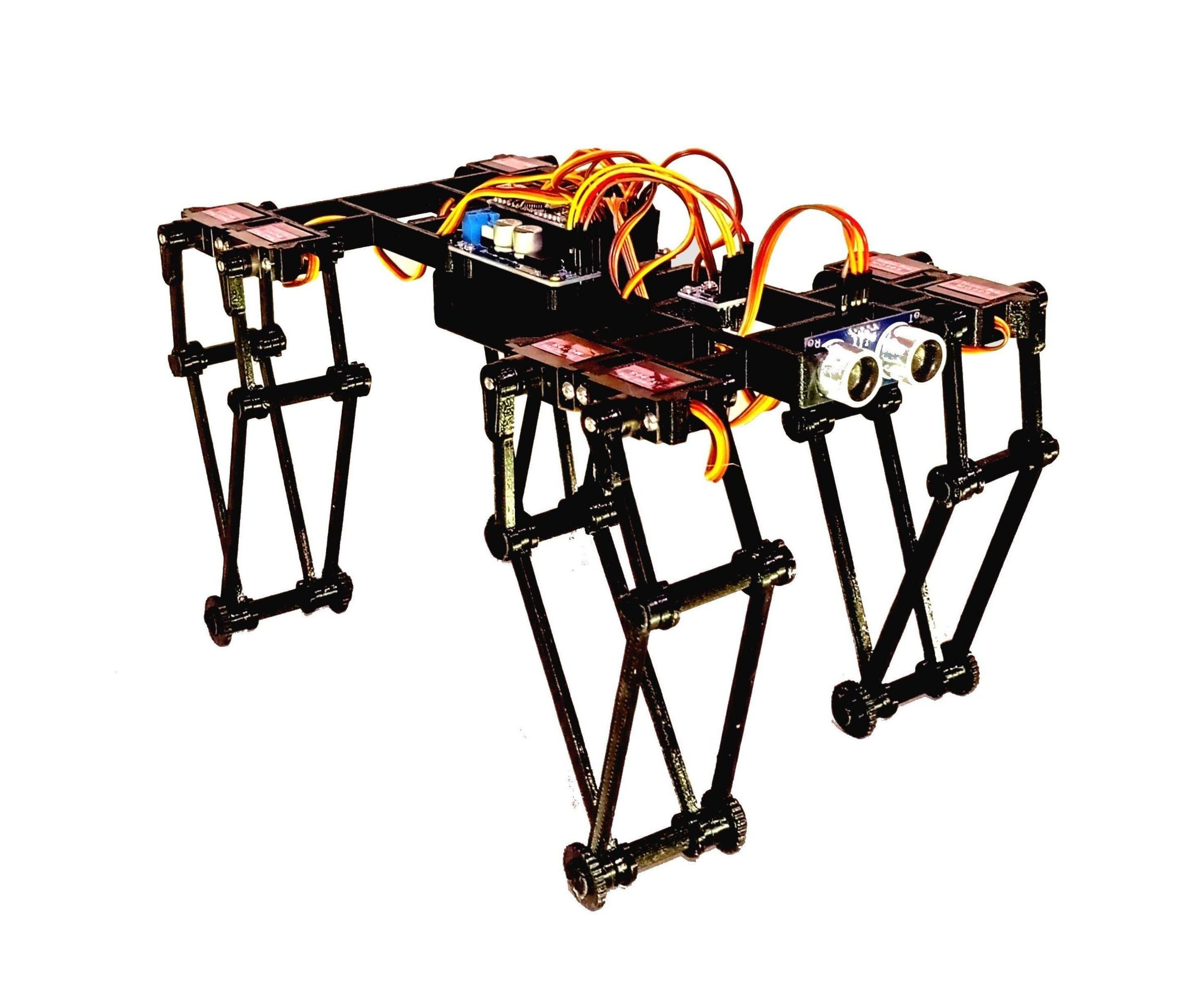

BORIS the Bipedal Orientation and Radar Intelligent System.
So why did BORIS come to be?
As a former design engineering student I remember the days when all we had at University was an arduino with a bunch of wires and sensors pointlessly plugged in and flashing to learn programming. I designed BORIS as an educational Robot whose primary purpose is to teach anyone who has an interest in robotics and programming as a whole how to move a servo or get a light blinking or get a speaker buzzing all in a more interesting and neat little package
Why is BORIS the best?
  • He's fast!!! with a revolutionary new leg design BORIS is one of the fastest biped robots in his size and price category so gone are the days where you have to wait half an hour for your robot to travel a meter and film a robot walking at 10 times the speed to make it look good on video.
  • He's easy to assemble!!! With only the use of a screwdriver you can have your BORIS up and running
  • He's overflowing with add ons!!! This is not just a bipedal walking robot BORIS comes equipped full to the brim with extra features and add ons that all make the most of well documented open source software and off the shelf electronics hardware so as that even the newest of newbies can have a go at learning how to make the robot truly do what he wants it to do.
    1. Ultrasonic sensor for obstacle detection and avoidance
    2. 3 axis magnometer (digital compass) BORIS knows which way is up and what direction he is pointing
    3. OLED Display His mouth can move!!!
    4. Buzzer He can make sounds!!!
  • He's statically stable!!! Do not fear the programming of the walking sequence is dead simple there are no complex algorithms involved to get this Robot moving.
  • He's 100% 3D printable apart from the electronics and screws for the electronics BORIS is fully 3D printable this reduces his price and also makes spare parts easy to replicate with a 3D printer

  1. Start by printing the LEG 1.stl files individually as these are the hardest to print they require a brim of around 5mm and one layer height around the part to avoid warping if for some reason the brim does not prevent warping print the LEG 1 WITH BRIM.stl file.
  2. Print the INDIVIDUAL CIRCULAR PIN .5mm L1, INDIVIDUAL CIRCULAR PIN .75mm L1 and INDIVIDUAL CIRCULAR PIN 1mm L1 once printed test the pins in the holes of the LEG 1.stl that you previously printed and select the one that fits the tightest without being to tight to not be able to push through the hole If possible use the .5mm one as the tighter the fit the faster the Robot will walk.
  3. Proceed to printing the rest of the GROUP.STL files
And there we have it about 2 days of printing later you should have all of BORIS's Plastic parts.
