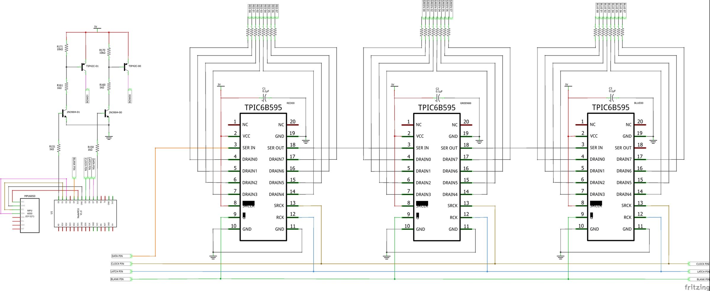

Step 2: SCHEMATIC
Circuit diagram for this project is as follows:
We have a total of 16 RGB LEDs arranged in 2 rows x 8 colums. Two row are controlled by transistors and eight columns are controlled by TPIC6B595N for each color ( 03 x TPIC6B595N for RED, GREEN and BLUE).

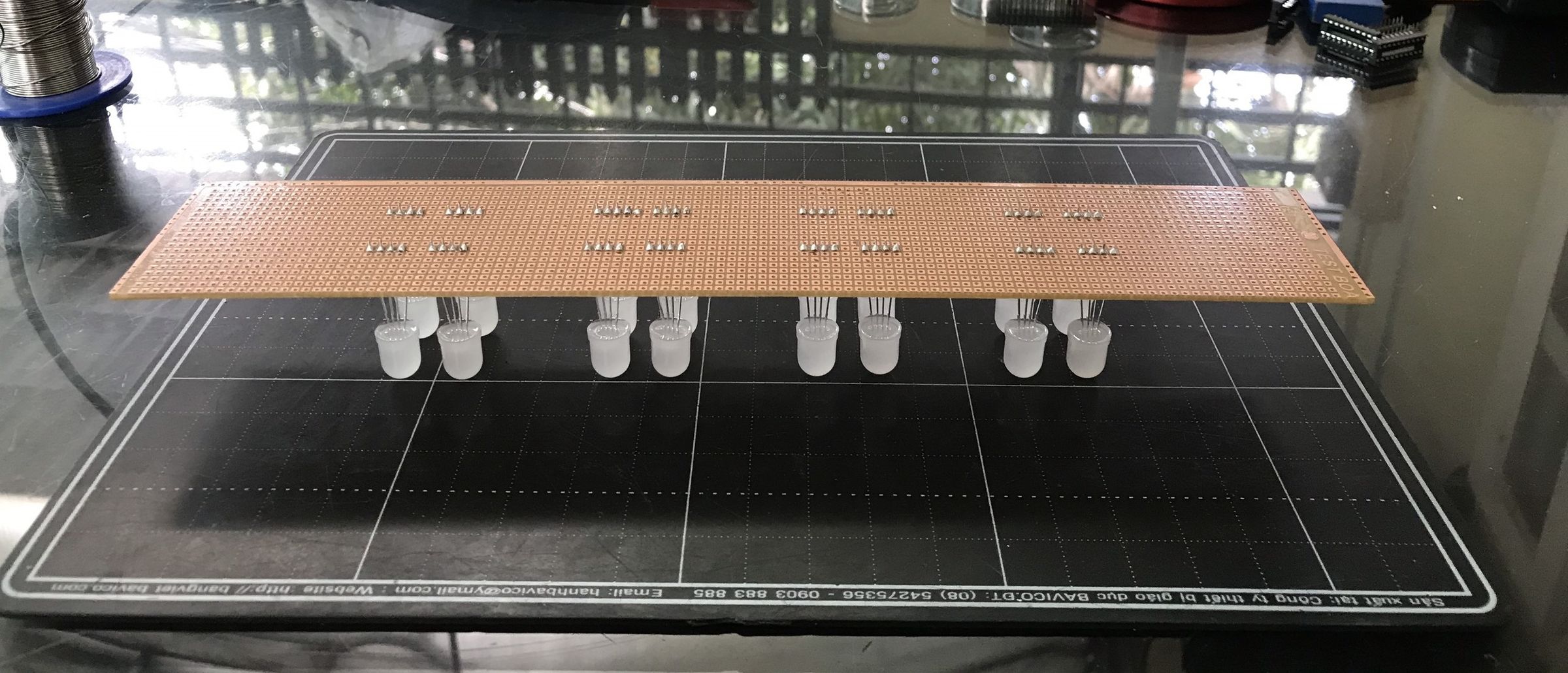

Step 4: SOLDERING WORKS
I've conducted the following steps:
- Choosing bottles: I used 04 x bird's nest glass bottles with diameter 50mm and height 70mm.
- Marking glass bottles on the copper prototype PCB size A4 then cut it in suitable size.
- RGB LEDs arragement
- RGB LED soldering

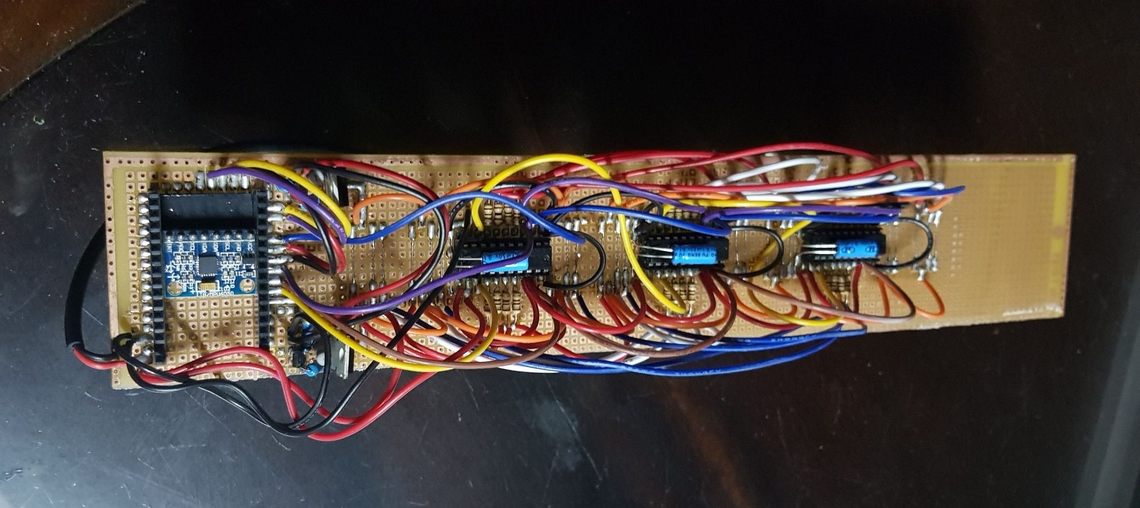

- Power Shift Register TPIC6B565N soldering: It's better if we use double-side copper prototype printed circuit board. In my case, I used a single-side printed circuit board so it should be a little bit difficult.
- Transistors and ESP8266 NodeMCU soldering
- Testing the circuit before it is covered by box and glued 04 x glass bottles on the PCB. FINISH.

- Updated schematic with MPU6050:
- Soldering MPU6050:
