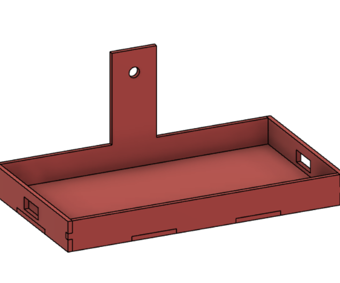

Step 2: Elaboration of the Base
Step 1: To start with the base we are going to click on the icon called ¨Create Sketch¨, after creating our Sketch we are going to select the "X" and "Y" axes.
Step 2: With the tool called "Line" we will begin to draw lines according to the measurements that are in the photo. When we finish drawing and closing the figure, a light blue base will be formed within the lines drawn.
Step 3: After closing the figure with lines we are going to give the box called "Finish Sketch", then we are going to give the box called "Extrude", we select the figure we made and specify the distance to extrude that would be 2.00 mm.
Step 3: DXF Image Placement
Step 1:To start you have to download an image of a banana in dxf.
Step 2: We are going to right click on the base and select the ¨Create Sketch¨ tool.
Step 3:After creating our Sketch we are going to go to the option called ¨Insert¨ and then we click on the ´Canvas¨ tool. After opening Canvas we will find our banana image in dxf format.
Step 4: Now that we find, we select our image, we click on the base of our box and the image will automatically be placed on top of our box.
Step 4: Banana Delineation
Step 1: Now that we have our image at the base, we are going to click on the “Fit Point Spline” tool, and we will begin to outline our image layer by layer in a pyramidal shape according to our criteria.
Step 2:After having outlined the entire first layer, we go to "Finish Sketch" and click on the "Extrude" tool and set the measurement of 2 mm.
Step 5: Completion of the Box
Step 1: After having finished all the layers. We select the main base we right click and we give ¨Create Sketch¨
Step 2: Now we are going to press the letter P of our keyboards and we are going to select the 4 edges of our Main Base and then we give it Okey
Step 3: We are going to give it ¨Finish Sketch¨ and we are going to extrude 18 mm our sides of the box. And we are done, now you enjoy your box of Banana
