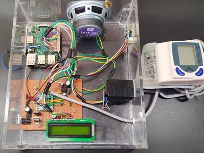

This project that we have made this time is capable of Classification Of Blood Pressure, Spo2, Body Temperature Monitoring, and announcing sensor Results Over The Voice Using Raspberry Pi. In this Upgrade Project, I Have provided the following parameters
1. SpO2 Monitoring
2. IR Temperature Sensor
3. LCD Display
4. Voice Broadcasting
5. Data Saving For Future ML Training

Hardware components
  • Raspberry Pi 3 Model B
  • Maxim Integrated MAX30102 High-Sensitivity Pulse Oximeter and Heart-Rate Sensor for Wearable Health
  • SparkFun MLX90614
  • Texas Instruments LM386
  • Speaker: 3W, 4 ohms
  • Adafruit RGB Backlight LCD - 16x2
  • Linear Regulator (7805)
  • Bridge Rectifier Diode, Single Phase
  • BP Sensor
  • TaydaElectronics DC POWER JACK 2.1MM BARREL-TYPE PCB MOUNT
