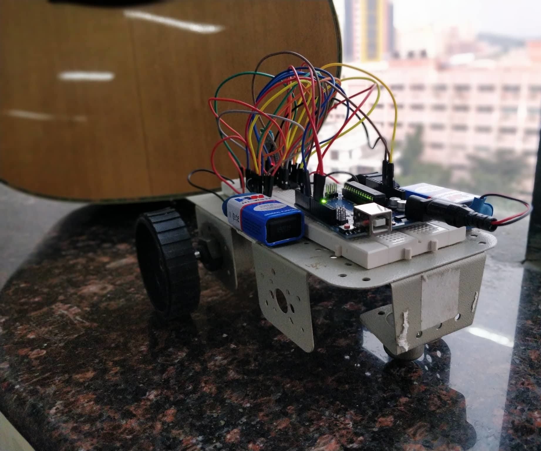

Step 5: THE CIRCUIT:
Step 6: CONSTRUCTION:
- While making the connections, ensure that the jumper wires being used are not faulty. This can be tested by administering the Continuity Test with a Multimeter.
- To ensure continuous, even supply throughout the length of the breadboard, short the two halves of the upper and lower power rails with the help of a jumper wire. To do this, insert the jumper wire between the fifth and sixths columns of the first row in the upper power rail and repeat the same with the lower.
- The Bluetooth Module used here is utilized in the Slave Mode. In case your module needs to be re-configured, use the appropriate AT Commands to do so.
- A 9V battery can be used to power the Arduino, however, only a 5V supply must be given to the Bluetooth Module.
- Take care to not interchange the connections made to the TX and RX pins of the Bluetooth Module.
- In case the motors rotate in opposite directions, reverse the connections made to the terminals of any one of the motors.
- An additional battery can be made use of in order to increase the rpm of the wheels.
