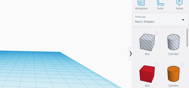

Step 2: Gather the Materials Onto the Workplane
  • Open the tab "Geometric Shapes"
  • click and drag the box onto the grid
  • look at the picture above to see to guide you

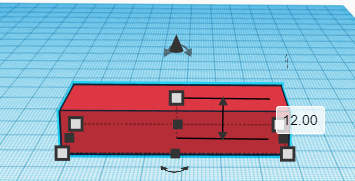

Step 3: Keychain Dimensions
Adjust the length to these dimensions
Length: 60 mm
Width: 20 mm
Height: 12 mm

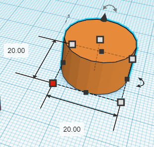

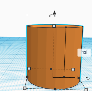

Step 4: Constructing Keychain Curved Edge
  • Drag the cylinder onto the work plane
  • adjust the height to 12 mm
  • input 20 mm for the number of all circular dimensions
  • Move the cylinder to the right side of the box

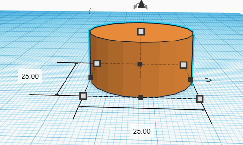

  • put the left half in the box as shown in the 5th picture.
  • Tip: When viewing, look at an aerial view to verify for a second time
  • Click on both shapes and use the group command (note that the color will change to one solid)
  • Tip # 2 Press shift to press both and group ( symbol of the triangle and semicircle)

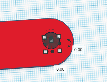

Step 5: Keyhole Tutorial

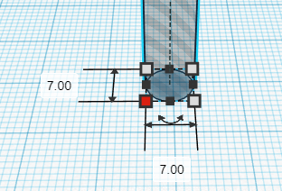

  • After grouping grab the cylinder hole shape
  • input the hole size to 7 mm x 7 mm
  • modify the holes' height to 12 mm
  • place the hole in the center of the circle and the box shown above.
  • Use the pic above to align in the center
  • press the "shift" key and combine both to make a hole using the group command.

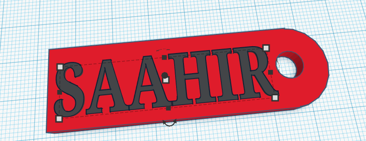

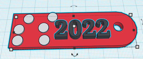

Step 6: TEXT TUTORIAL
  • Scroll down to the same tab of "Geometric/ Basic shapes" until you reach "Text"
  • Once you find the shape, drag it onto the grid.
  • In the picture shown above in the first bar labeled text, you can input anything for your text.
  • For example, on my keychain I wrote my name (Saahir) you can change the color as well
    Tip: you can do anything, my design or anything else.

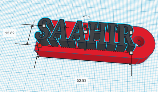

  • Once you're done writing a small text, raise it from the grid up to 12 mm (keychain current level)
  • Tip #2: adjust the dimension to fit the keychain (pic 2 for example dims)
  • decrease the keychain to mm and decrease the text as well to make it slightly above shown in the third pic a
  • FINALLY, YOU HAVE COMPLETED THE TUTORIAL OF MAKING A KEYCHAIN
