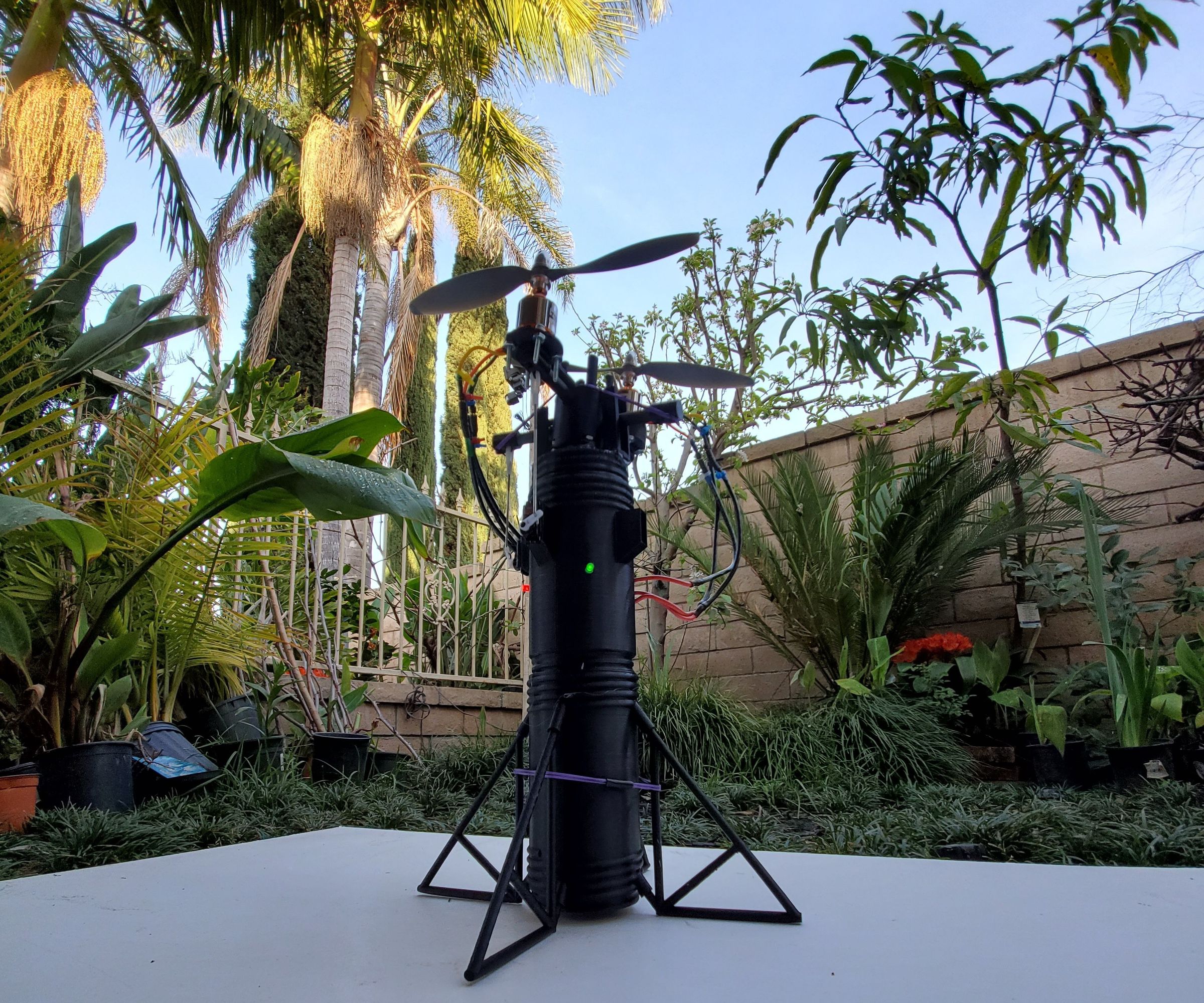

Due to 3D printer tolerance issues, the diameter of the holes for the LED may need to be enlarged slightly. I used a drill bit to do this. Then, insert the LEDs and connect the positive lead of each LED to digital pins 2-11 of the Arduino and the negative leads to ground of the Arduino. I powered the Arduino through the VIN pin with the 5V output from the ESC and connected the signal pin (white) to pin 12 of the Arduino. I connected ground of the ESC to ground of the Arduino. Make sure there is a universal ground by linking all ground pins together.
Make sure to solder the 3 leads on the other side of the esc to the 3 leads on the motor. Then connect the battery to the 2 leads coming from the esc. See the diagram for a visual explanation.
I did not use any resistors because the light was on for so little time. In the span of 1 minute, the light is only on for 1.05 seconds given the 1.75% duty cycle. Therefore, a relatively low amount of current was used (25.6 microAmps). The Voltage was also relatively low at (0.161 Volts). I used AC current and AC voltage because the light is oscillating on and off.
