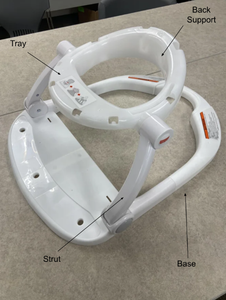

Step 1: Assemble Seat and Remove Feet
Once the seat is assembled remove the rubber feet on the bottom. Be sure to save the screws as they will be used later in Step: 10 to install the battery box. A sharp chisel can be used to cut off the raised plastic lip around where the rubber foot was. This will allow the base plate to be flush with the seat.
