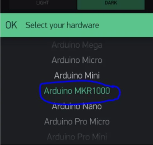

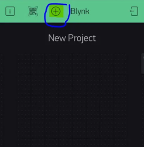

Step 3: Create New Blynk Project
  1. Press on + button in order to create new project
  2. Change the project name
  3. Under "CHOOSE DEVICE" choose Arduino MKR1000
  4. Press Create

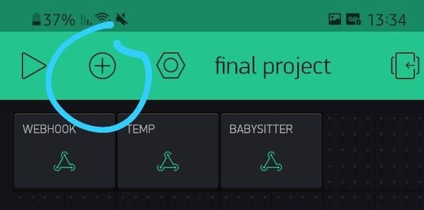

Step 4: WebHook in Blynk
1. Press on + button to add a new widget
2. Under "other" section choose WebHook
3. Change the the WebHook name
4. Choose a available virtual pin uder "Output" section
5. Paste the URL of the Integromat's Webhook under "URL" section, for example:
https://hook.integromat.com/fd65o6rjnxwqoqx2gvlr86...
add to the url ?var=/pin/ where var is the name of the variable that you declared in Integromat
6. Press ok
