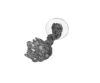

First thing to make this dancing baby groot is to print the parts made on Auto Cad Inventor 2014. They are fairly simple and the head is actually part of a different project that I took online. Not necessary but recommended for this project. The head file is not scale to size and you have to cut the body off but that can be easily done by putting the bottom of the head to 1.7 cm diameter That will scale the head to the right size. Moreover, the rest of the project consists of two body parts, two forearms and two arms. All of the pieces have pegs or hole so it is easily connectable. After assembling all the parts appropriately (cannot make a mistake assembling since each piece has a specific size peg), the next will be building the circuit and connecting to the 3d printing parts.

Step 5: Designing
As you can see from the image, I have put something over the parts so it will look more like baby groot. The partsare supposed to be just the mechanism. To look more like baby groot you will need brown tissue paper, glue and crafting skill. You just twist the paper while glueing and it will look like that image. Be careful not to put a lot of tension because the stepper will not enough power to turn the body or if it does it will just rip. So try to loosen up the tissue paper around the joint.
