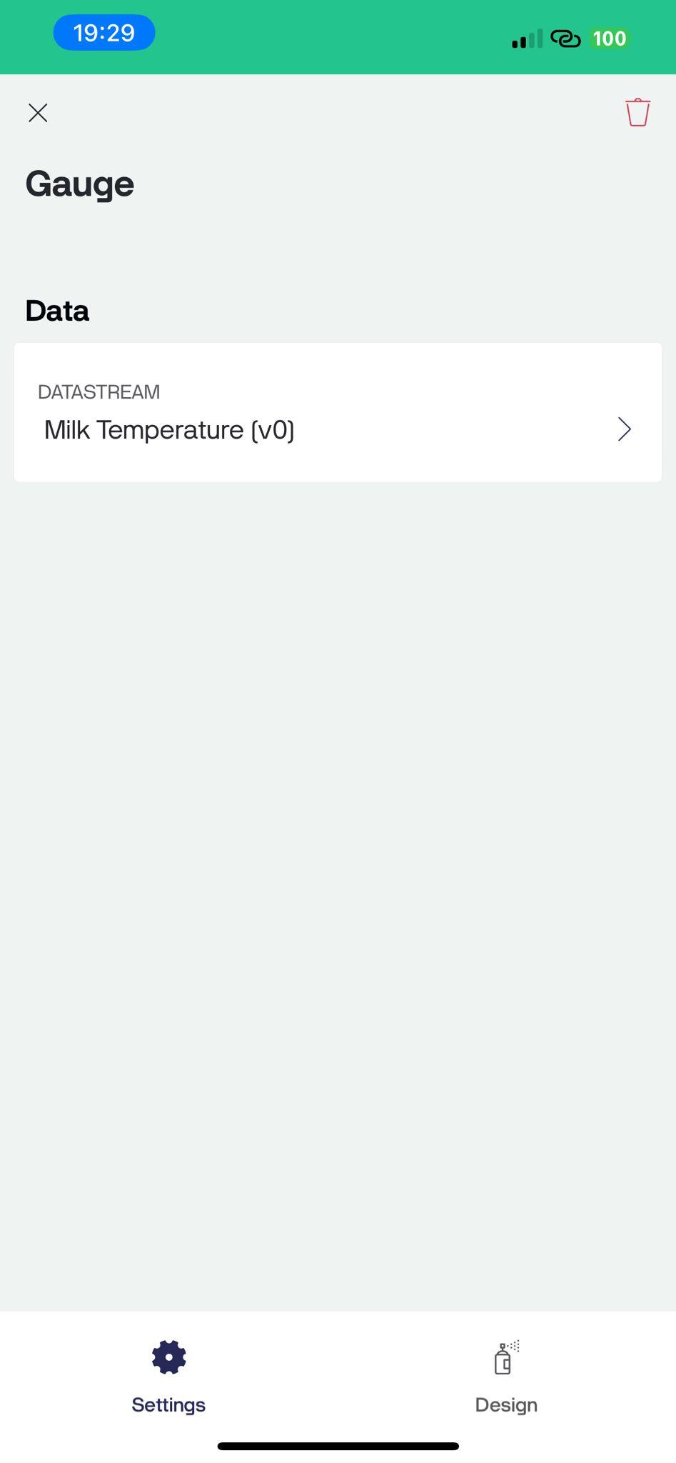

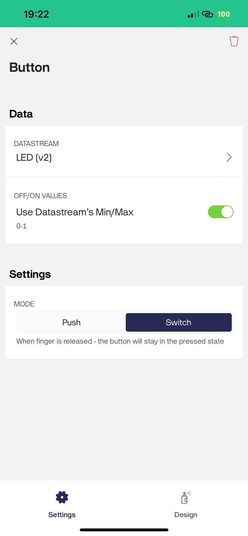

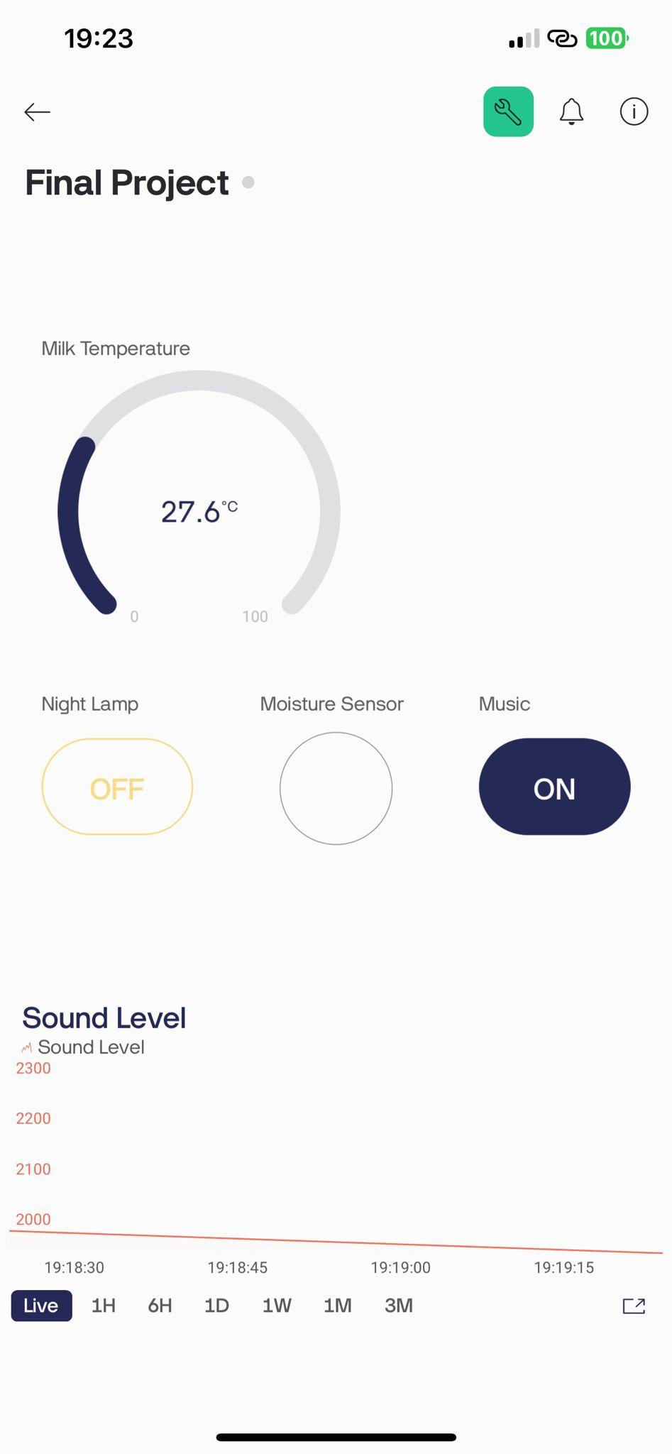

We created 5 datastreams:
  • v0 - virtual pin datastream of type double which will be used to measure the milk temperature for the baby
  • v1 - virtual pin datastream of type integer which will be used to play a lullaby for the baby when he cries
  • v2 - virtual pin datastream of type integer which is used to lit a night lamp when needed
  • v3 - virtual pin datastream of type integer which will be used to detect if the baby's diaper is wet
  • v4 - virtual pin datastream of type integer which will be used to display the sound level of the baby
3. Click on the search tab and you'll see a "New Device" button, create a new device from the template you've created, you will get few lines of code with your device's information - save it, we will use it soon.
4. Open the Blynk app on your mobile and add buttons to the device according to the description in the figures

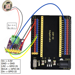

I2S AUDIO AMPLIFIER:
  • VIN (or VDD): Connect to the 3.3V pin on the ESP32.
  • GND: Connect to a GND pin on the ESP32.
  • LRC (or LRCLK): Connect to GPIO 25 (S pin) on the ESP32.
  • BCLK (or SCK): Connect to GPIO 26 (S pin) on the ESP32.
  • DIN (or SD): Connect to GPIO 22 (S pin) on the ESP32.
Speaker Connections:
  • L+ on MAX98357 -> Positive terminal of the speaker.
  • L- on MAX98357 -> Negative terminal of the speaker.
