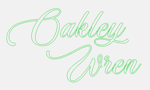

Step 1: Design
The key to the project is to ensure all pieces individually will fit inside the working area of your laser engraver.

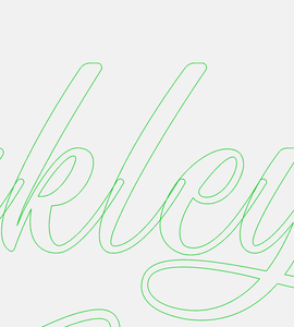

Add a text object and type out the full name. You will need to pick a script-style font where the lowercase letters can be welded together (we used one called Weather Sunday). Use the spacing and leading font settings to get everything lined up and make sure the lowercase letters will weld correctly. Increase the size of your font to get the largest overall size while keeping each individual piece within the limits of your machine. I found it helpful to draw a rectangle to represent my work area.

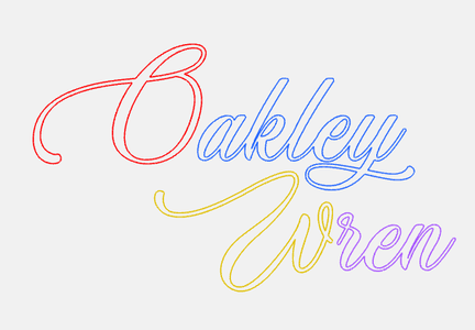

Once you have determined the appropriate font size (ours was 700 pt.), add four separate text objects: one for each capital letter and one for the lowercase letters of each name. You will need to weld the lowercase letters together.
Step 2: Cut Out the Pieces
Layout your text objects to maximize your use of material. I was able to get all of mine with only three of my 12” pieces of MDF. Below are the settings that I used:
