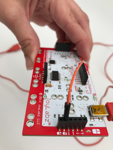

Step 2: Back of the Board: Output
The first video explains WHY you should not use the 5V out pin if you have an older Makey Makey. It is best to use the KEY OUT pin for output on any version.
There are a couple of different versions of Makey Makey, but all Makey Makey have these pins: KEY OUT, MS OUT, GND.
Here is what they do:
KEY OUT: This will send voltage out if you press any key on the Makey Makey. (Arrow keys and WASDFG)
MS OUT: This will send voltage out if you interact with any of the mouse inputs. The mouse inputs are all available on the right header on the back of the board. (We will explore those on step 5!)
GND: This stands for "Ground" and functions as another way to use EARTH input and complete your circuits. You can use the GND for EARTH or any of the EARTH inputs on the bottom row of your Makey Makey.
In the second video, you will learn how to create light up an LED by pressing any key on the Makey Makey.
- Put a jumper wire in KEY OUT and connect it to an alligator clip and the positive leg (the longer leg) of an LED.
- Connect an alligator clip to EARTH and connect the other end to the negative leg of the LED.
- Once this is connected, test your connections by holding EARTH with one hand and pressing on any key press.
Educator Tip:
The voltage on the constant "5V" pin is too high for a regular LED, please teach students how to use the "KEY OUT" pin and how to build a switch to make the light come on.
The OUTPUT header on version 1.2 has: KEY OUT, MS OUT, 5V, GND, PGD, PGC. The PGD and PGC pins should never be used. You can use the 5V pin to test motors, but we do not suggest you use the 5V voltage pin for LEDs without a resistor in place.
The OUTPUT header on version 1.4a has: KEY OUT, MS OUT, GND, GND, GND.

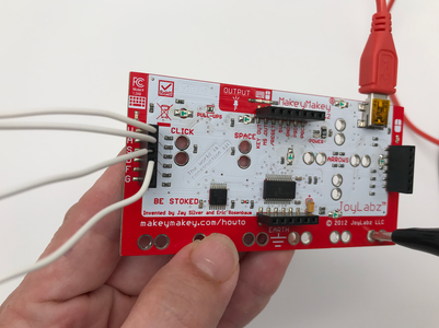

Step 5: Back of the Board: Mouse Control
You can also use the output to light an LED (or power a motor) by using the MS out pin on the top header and using the Mouse controls located on the right side header.
To control the mouse with your Makey Makey, you have to use jumper wires in the right header.
The up arrow on the head, controls mouse movement up, the down arrow controls down, etc. The 5th pin controls "right click" and the last pin controls "left click."
By using the MS OUT to power an LED, it will only light when a mouse input is read on the Makey Makey. The Mouse inputs are all on the right header and also include CLICK.
You can power two different light sources (or motors) by using KEY OUT and MS OUT.
