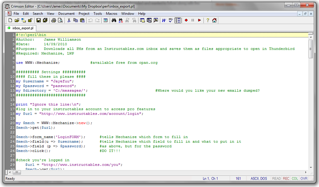

Step 3: How It Works...
These are roughly the steps that the code follows to get the result, a great big folder full of all of your messages....
It's not important that you read this, but I added it incase anyone was interested and wanted to follow along with the code.
1) It takes the values from the settings section and uses these to log you into your account
2) It checks that your password is right by visiting instructables.com/you and checking the title of the page contains your username
3) It visits your inbox and grabs the total number of messages (it's listed near the bottom)
4) Next the script iterates through your inbox pages, lapping up all of the links to your messages and storing them in an array for later
5) The script now has a big list containing the URL of each of the messages in your inbox. At this point it prints the total to the screen to let you know it's found them all.
6) Now the waiting begins. This bit can take a long time depending on how popular you are. The script loops through the array of URLS, visits each one, extracts the date, sender, subject and message from the HTML and adds it to a load of code that's saved as a .eml file.

Step 4: Running the Script
To run the script, download the file from this step and rename it from inbox_export.txt to inbox_export.pl.
Open the script in a text editor and enter your username, password and the folder that you want your messages to be saved to. This folder must exist before you run the script.
Run it as you did those in step 2.
Wait a bit, if you read the previous step you'll know it could take a while! For the more active/popular/spammy (delete as appropriate) instructables users it has thousands of web pages to visit! Ouch!
