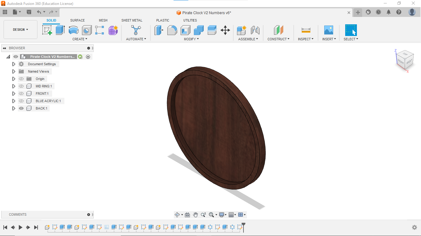

If I were to do this as a project in one of my classes the next step I'd have my students complete would be to create a few concept sketches. Mostly, so they don't just get stuck on using the very first, half thought through, idea that pops into their heads. Some students can run with their first idea and it turns out great, most students try their first idea and realize they should have been more open to listening to their teacher's suggestions before diving head first into a flawed design.
I skipped sketching ideas to save some time and jumped straight into designing on my laptop. I teach CAD with Fusion 360 for all of my classes. Before starting my 3D model on the computer I measured the wall clock from my other room as reference. I didn't want to make my clock much, if any, bigger than the one I had before. The clock measured 12" in diameter and 1-5/8" thick.
Using those dimensions as a guide I came up with this for the back portion of the clock which will house all of the electronics and clock components.
The battery packs I plan to use are left over from another project. I didn't measure the battery pack until after I had most of the back design done. Once I did I realized I would need more than the 1/2" deep pocket I could create with the 3/4" plywood I planned on using. I created another ring to add a little more depth to the back part and provide room for the clock mechanism and the battery pack.

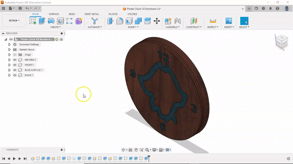

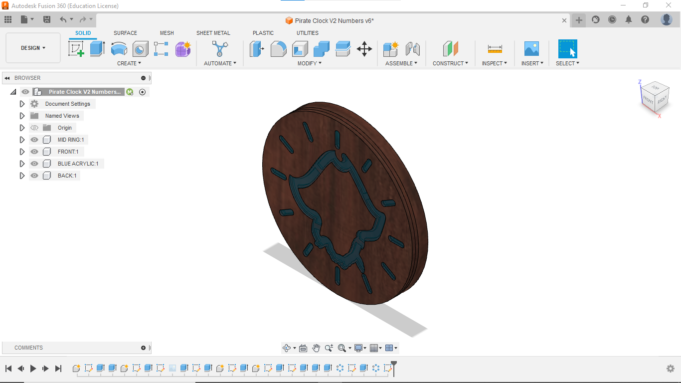

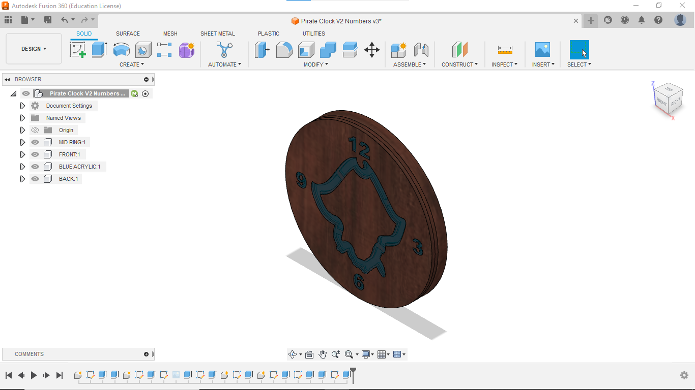

After about four different iterations of designs for the clock face I landed on the idea of having our school mascot at the center and having numbers or tick marks around the outside to indicate the time.
Clock Face with Numbers
Clock Face with Tick Marks

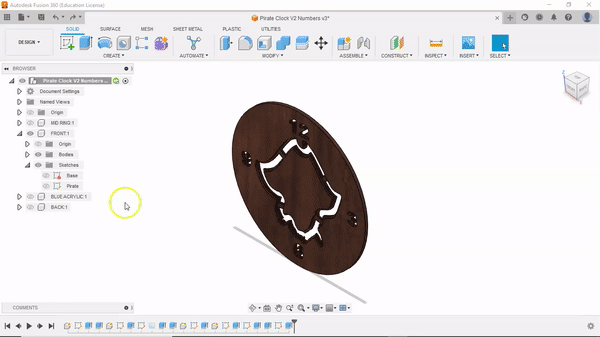

Fusion Tips for Laser Cutting
Export Sketch to DXF Format
At this point I'm going to mock up these designs with cardboard using our laser cutter. To run these clock faces on the laser I needed to export them to DXF format. To do that in Fusion 360 you need to:
1) Find the sketch you want to use in your browser
2) Right click on needed sketch
3) Select "Save as DXF"
Renaming Items in the Browser
If you teach with Fusion, or really any CAD software, I would definitely recommend teaching and making it common practice to have your students rename their sketches, features, and components as they create them. This way when they need to go back and find something or rework a portion of their model (which they always do) they (and you) don't have to search through 100 different sketches to find the one they need.
In Fusion 360 its really easy to rename an item in your browser.
1) Left click on the item to select it
2) Pause for a second
3) Left click the item again.
4) Type the name you want your item to have
5) Press "Enter" on your keyboard
Multiple Sketches for One Part to One DXF
Sometimes, you may have a part of your design that you want to export as a DXF but you created it by using multiple sketches. In that case the quick, simple fix is to:
1) Activate the component your sketch is in from the browser
(Sometimes you may need to have the entire design activated depending on the order you produced your parts)
2) Create a new sketch on the face/design you want to export
3) Use the "Project" tool to project all the edges, lines, and features of the face of that object you need.
(You can activate the "Project" tool by hitting the "p" key on your keyboard.)
4) Finish your sketch
5) Rename your sketch (I usually rename it to something like "laser sketch")
6) Export that sketch as a DXF file

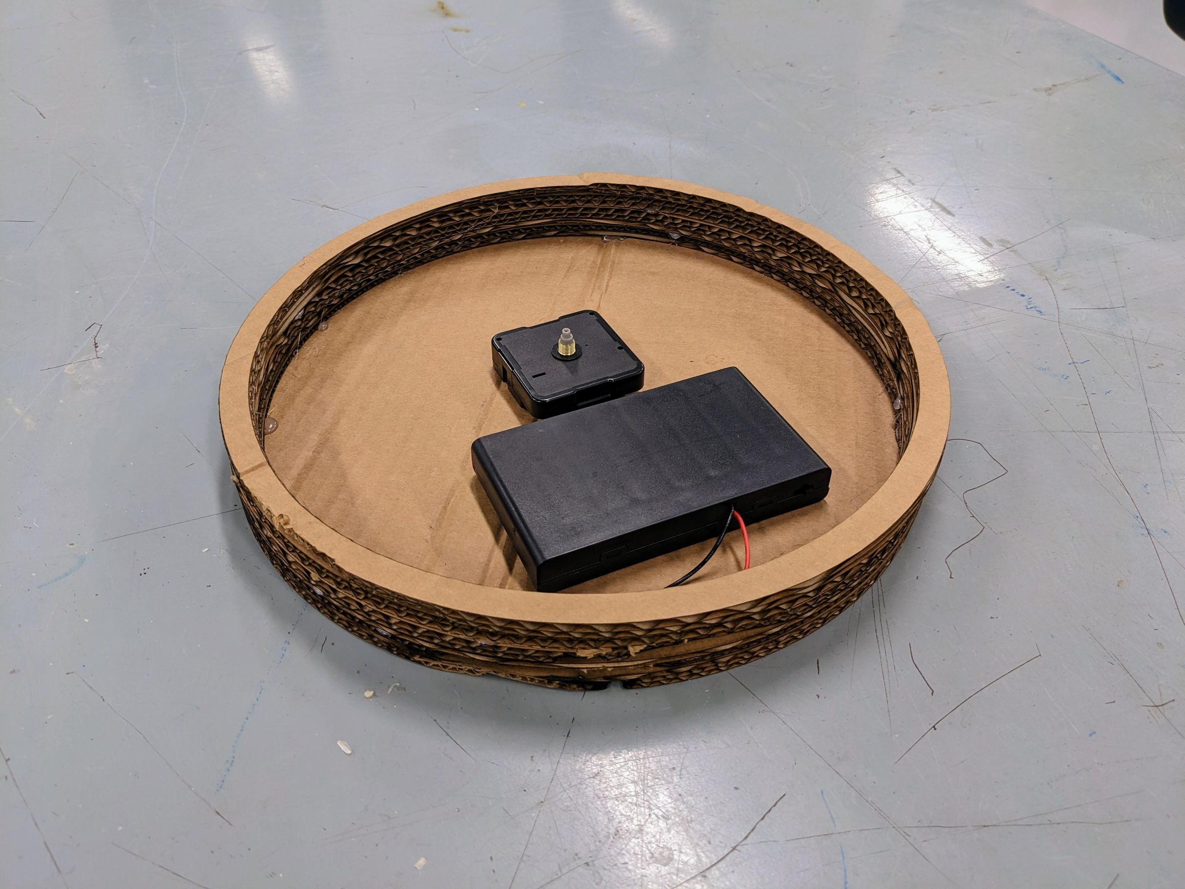

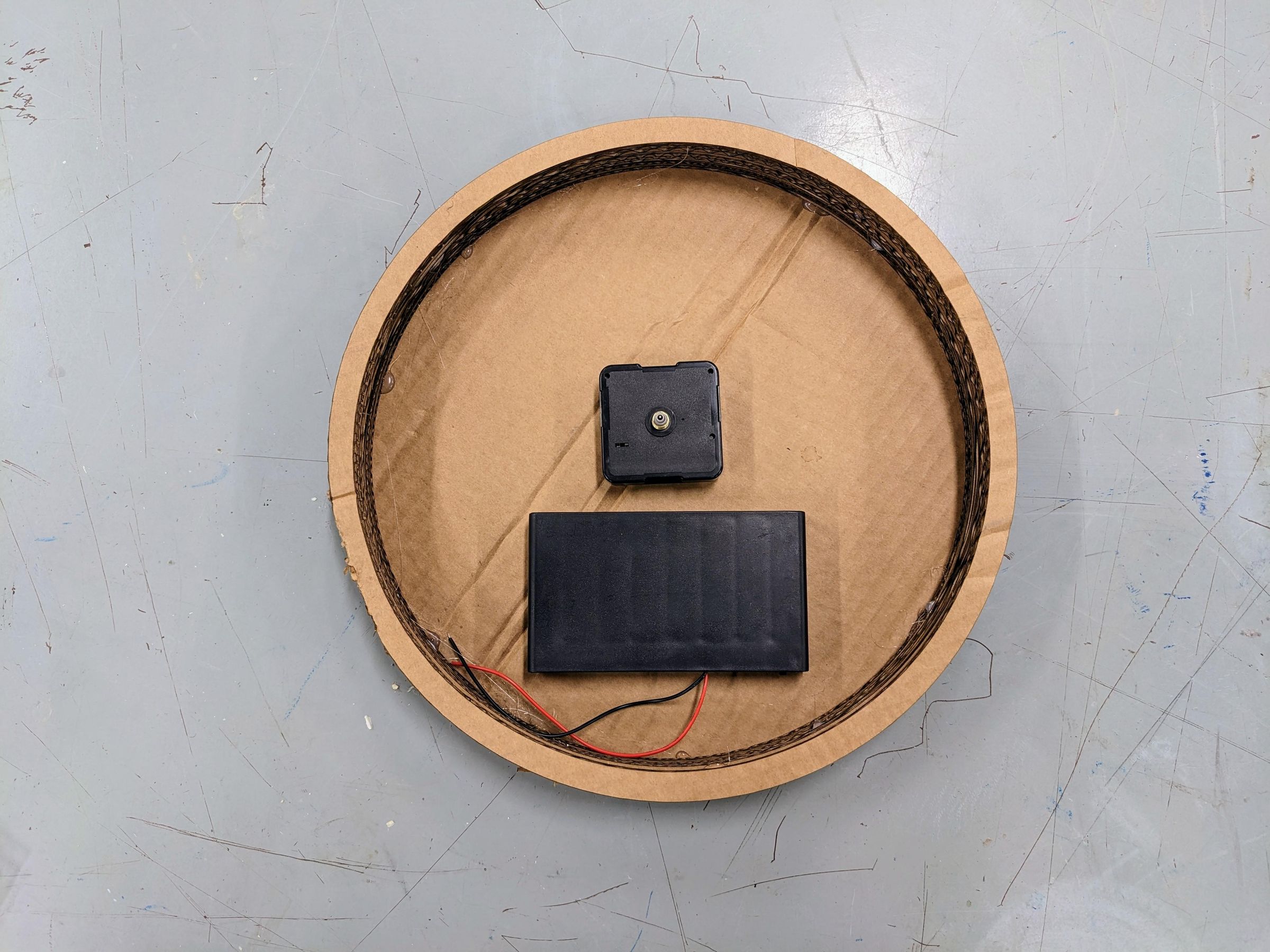

I always like to make an extremely cheap version of my designs before I move onto the more expensive material. In this case I used some corrugated cardboard to mock up the back of the clock and the two clock faces.
For the parts of my design that are thicker than a single piece of cardboard I just break up the model into several slices and glue it all together.
Mock Up of Back Part
This part should work as designed and easily holds all the internal components for the clock.

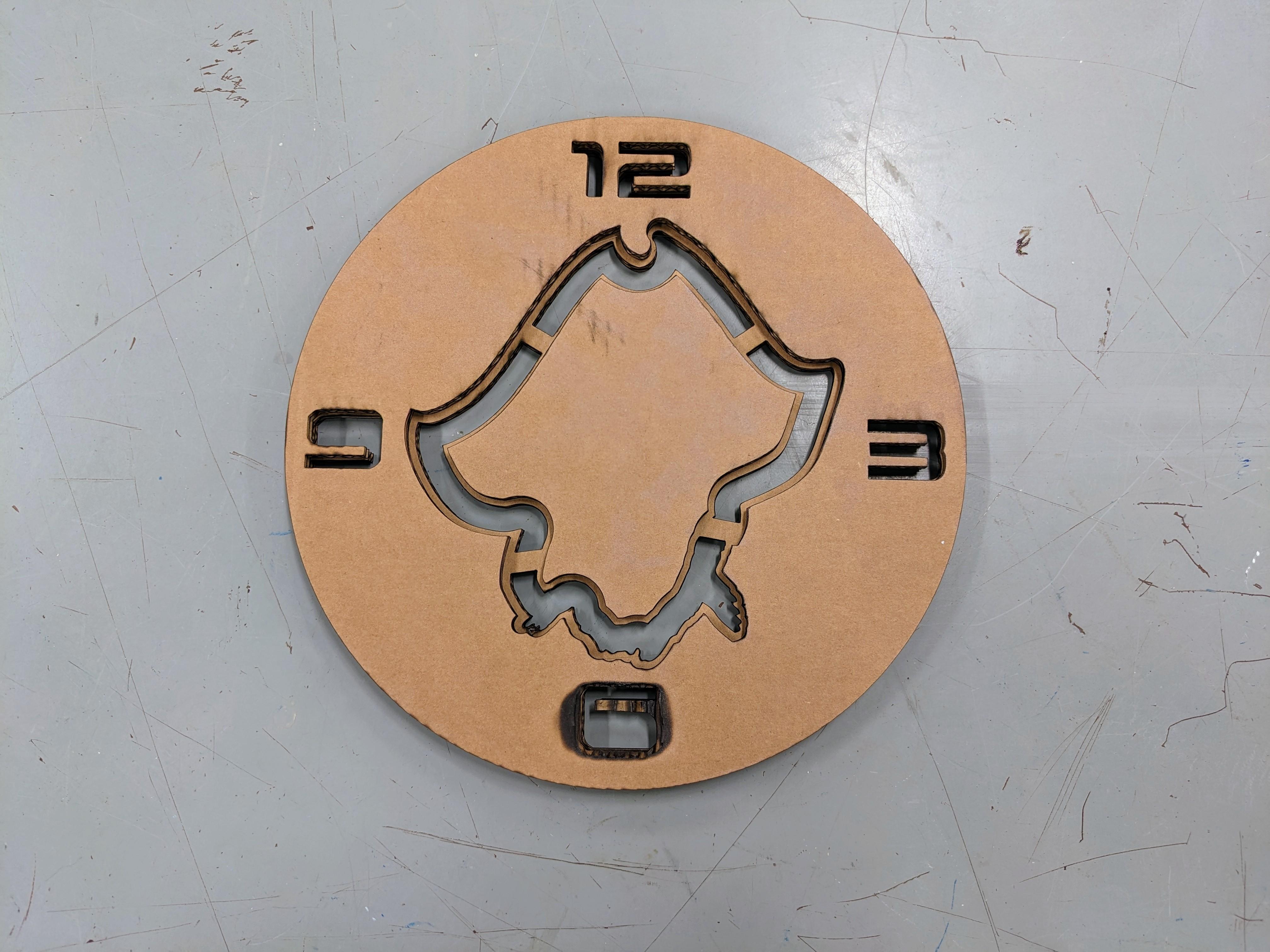

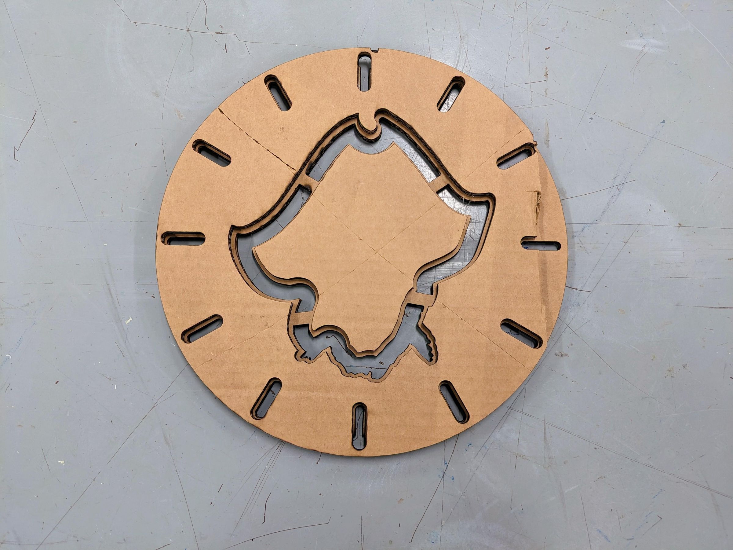

Besides a little charring from the laser, both the clock faces turned out pretty well! I didn't like the font for the numbers from Fusion so I changed that up in our laser cutter software before cutting it out.
Number Version
Tick Mark Version
I thought the clock faces turned out looking pretty cool, but I did find one mistake I made. The tops of the numbers/marks on the faces overlap the ring from the back part.
Because I'm making the pirate head and the numbers/marks backlit by LEDs that overlap would really throw off the look I'm going for with this clock.
I decided to move forward with the tick mark version. I went back into Fusion 360 updated the model to not overlap on the back ring and moved onto getting set up to run on our CNC router.

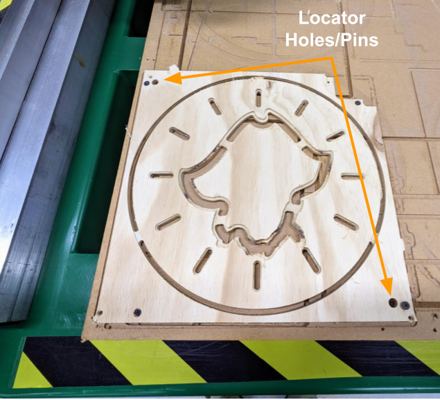

Step 5: CNC
As much as I would like to have a one stop shop software for design and CNC programming, I've yet to figure out how to get Fusion 360 to work with our CNC router. I'm sure there is a usable working NC file extension I can use but I've tried several up to this point, including the language/extension provided by the maker of our CNC routers and I've never been able to get the process to work.
If anyone has any tips or suggestions to help me figure out Fusion 360 to our CNC router please send them my way in the comments or in a message.

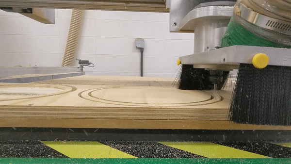

Because of that we do all of our CNC programming of toolpaths in a software called Aspire. Overall, it's not the worst thing in the world to teach my students how to work between two different software programs to complete a project and I can use the same DXF files I exported earlier to set up my toolpaths in Aspire.

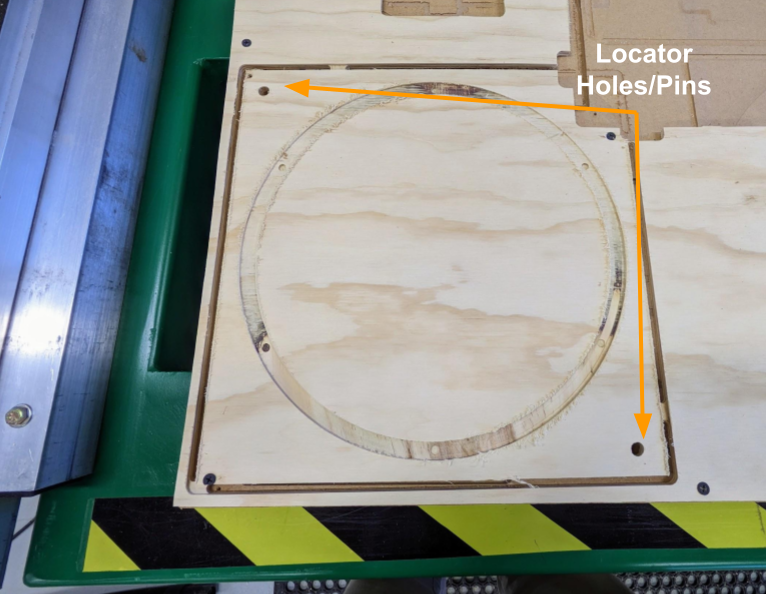

The CNC programming aspect of these parts is pretty straight forward. The only operation I had to do some real work on was the clock face. I decided to add a lip and holes for magnets to the back side of the clock face. To complete the work on the face there was going to need to be toolpaths that ran on the font and the back of the material which can cause issues if features from one side to the other are not aligned.
I decided to create a couple of locator holes that I could use dowel rod pins to make sure my part stayed properly positioned during both front and back processes. It had been awhile since I had tried something like this but overall it worked pretty well.
Back Side of Clock Face
Front Side of Clock Face

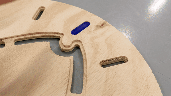

Running all the parts took about 30 minutes in total, most of that was the setup and changing of tools. The longest toolpath was the pocket for the back part of the clock which will house all the electronic components, which took about twelve minutes with a 1/2 inch end mill.

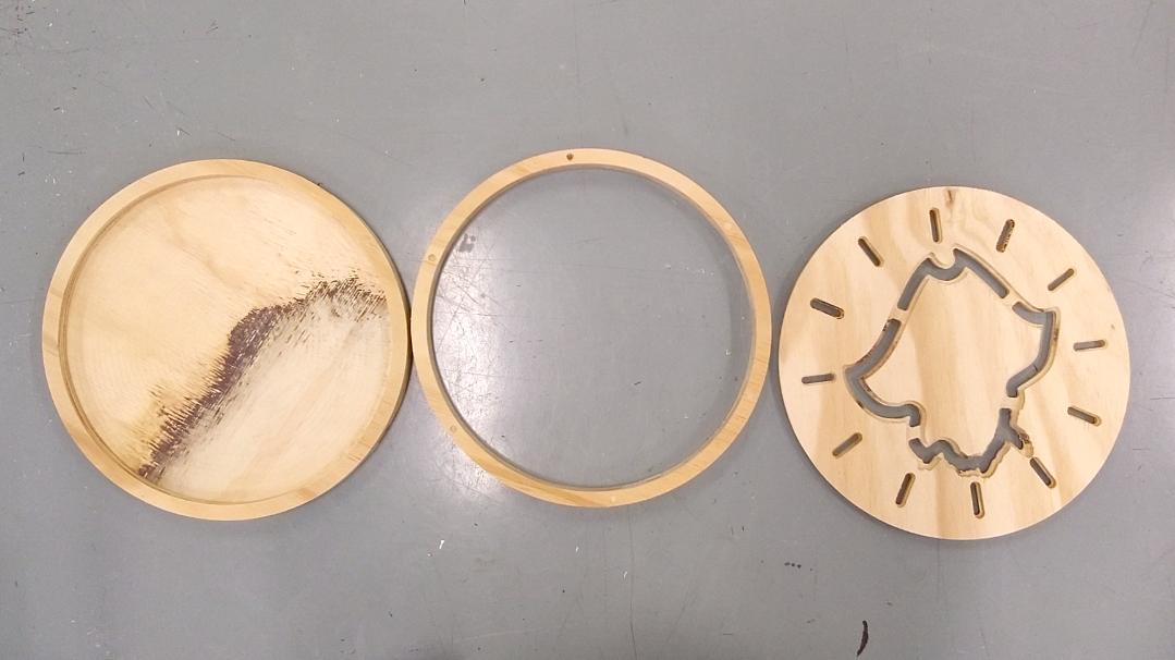

Once all the parts were cut out from the sheet of plywood and the tabs and frays were sanded clean they came out looking like this:

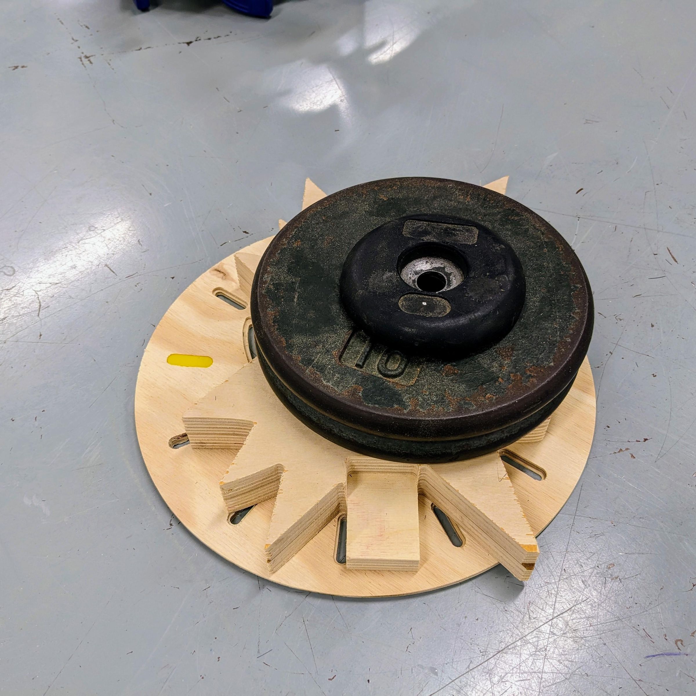

The biggest issue I ran into was the warping of the plywood which caused the depth of my toolpaths to be inconsistent. This is an issue we run into pretty frequently in our shop because we have to buy our material in bulk for a chunk of the school year instead of just purchasing right when we need it. Some cuts were too shallow, others too deep, and a few came out in the "Goldilocks Zone."
I don't think this isn't a big issue for me. When this is assembled and up on the wall you won't really notice those inconsistencies much, if at all.

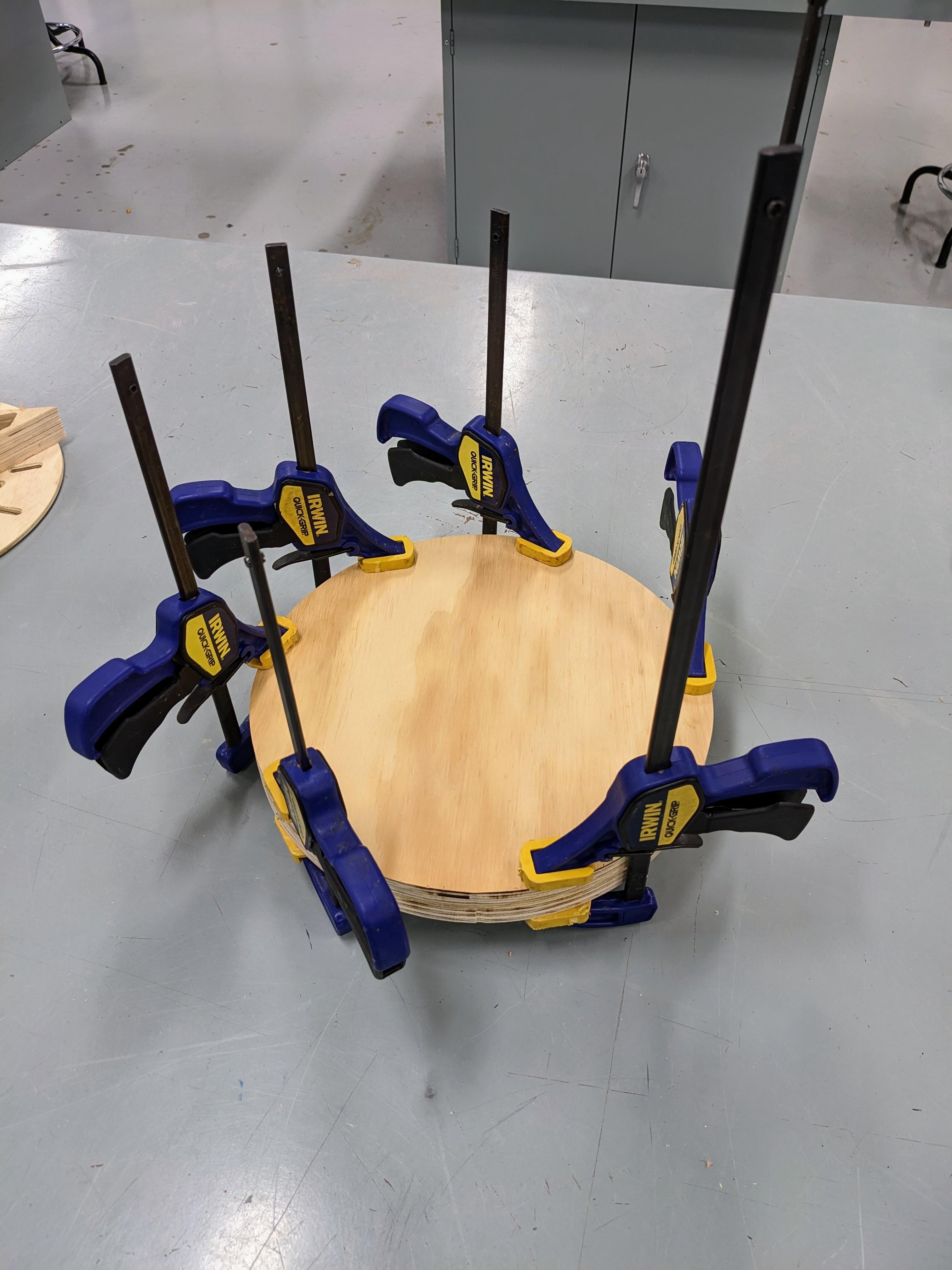

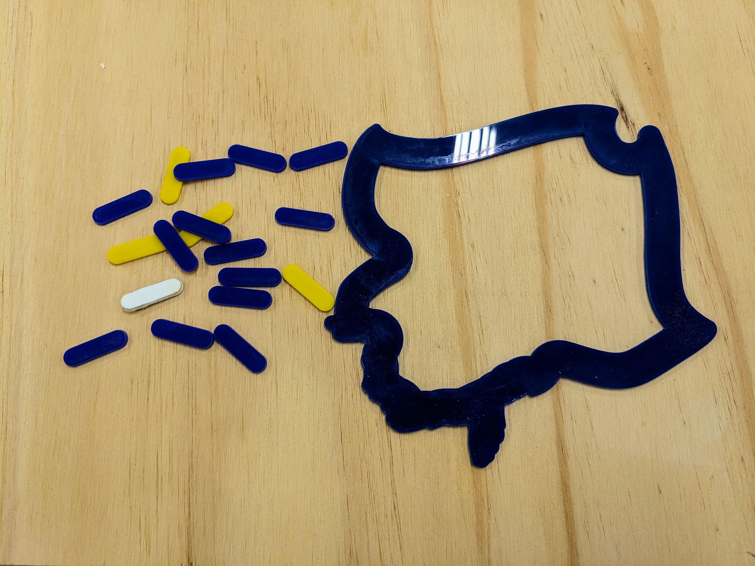

I glued up the back and the middle ring to get the depth I need,
put some weight on the clock face on the off chance that may help flatten it out a little before I assemble it,
and I went and ran all of the acrylic parts that will be installed on the clock face.

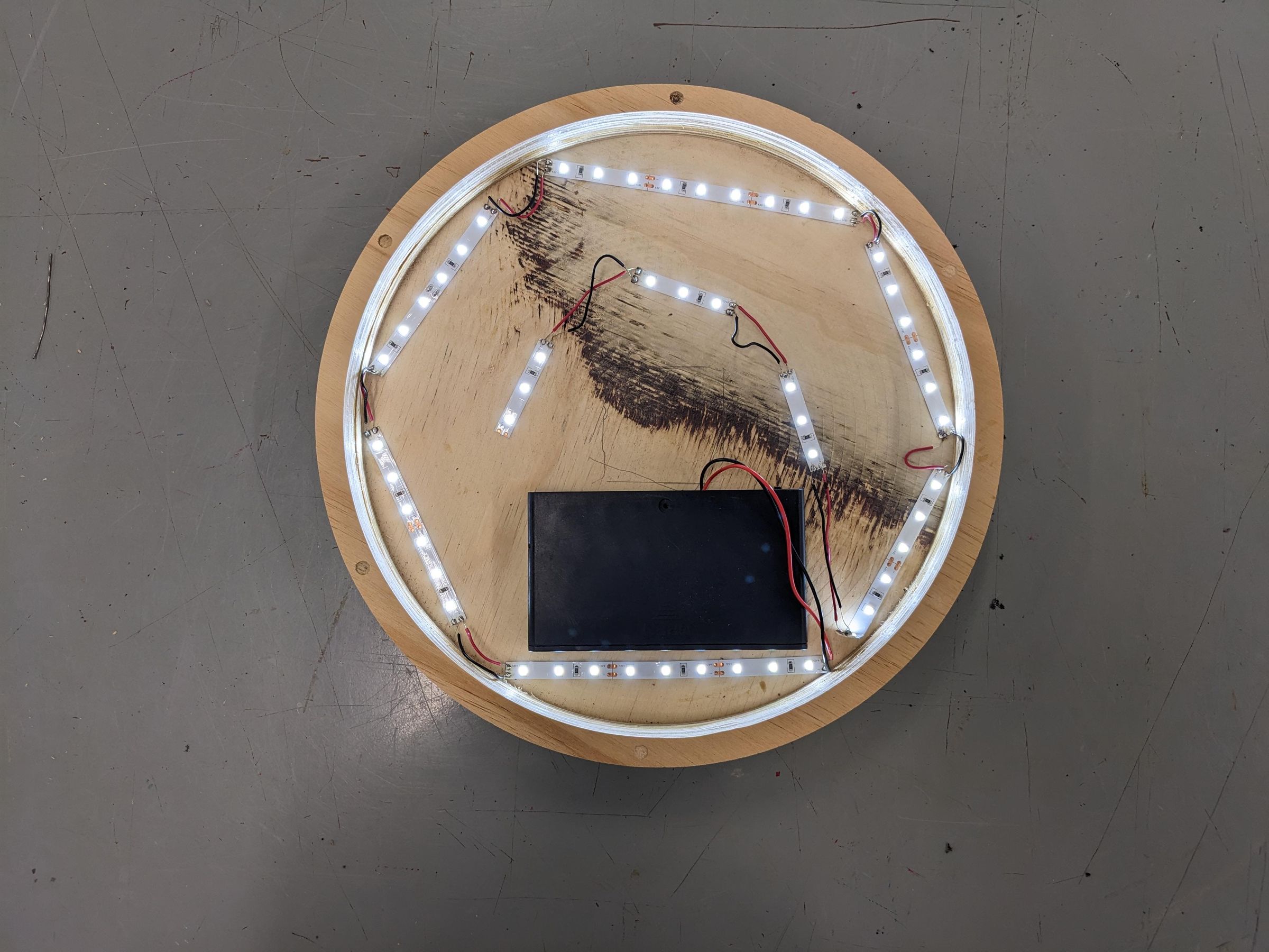

Step 6: LED Circuit

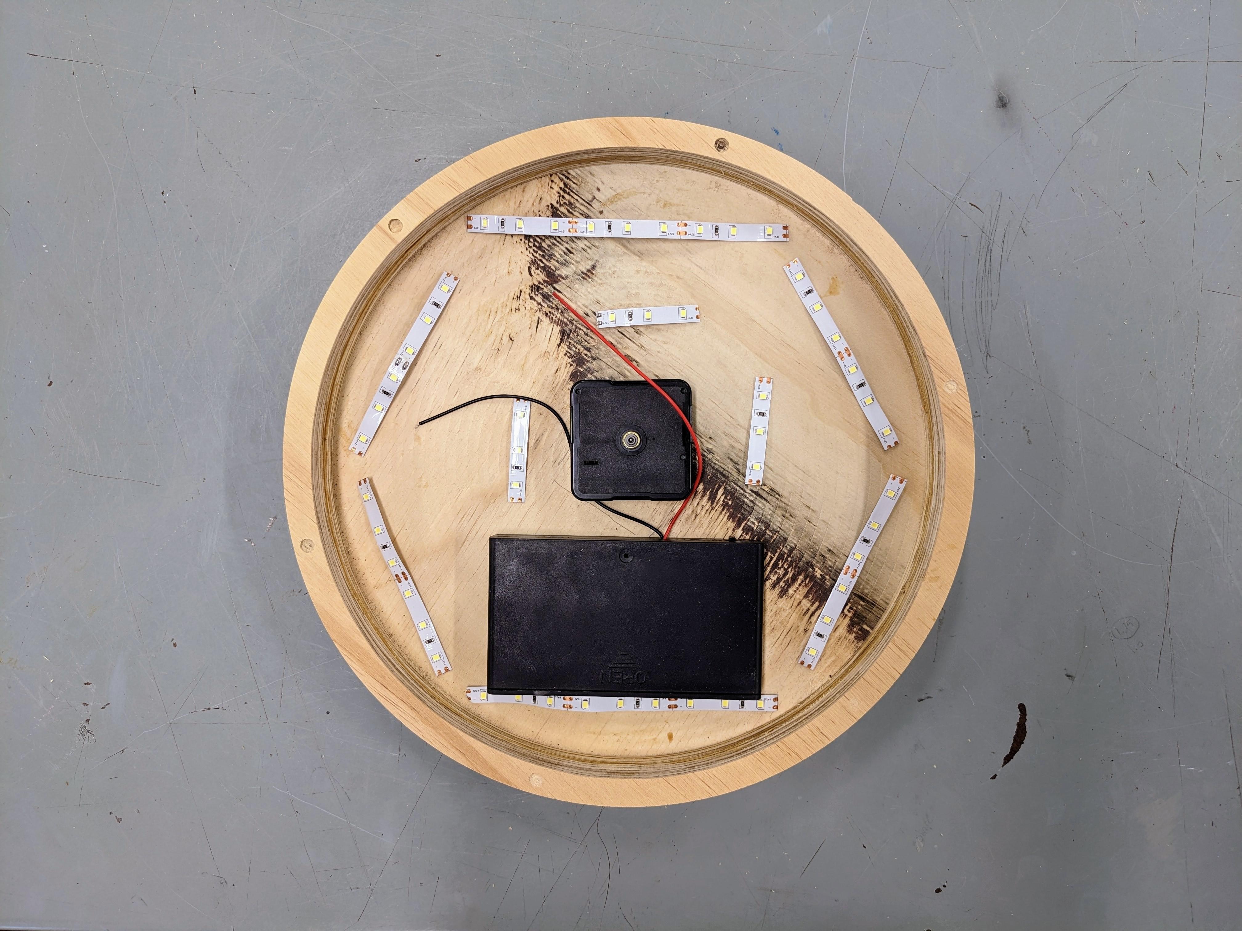

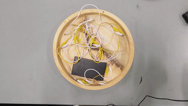

This is absolutely my weakest area of personal skill and in teaching. Soldering and working with electronics in this way has always been a struggle. Even simple things like this take me twice as long as they should. All I wanted to rig up was some small sections of LED strips to provide the light to illuminate the acrylic.
My first thought was to test fit all the components together with aligator clips to make sure I have the setup correct before soldering. I tried this idea for about 10 minutes and it turned out to be more of a mess than being useful.
I abandoned the alligator clips and laid out the parts as I best as I could in the back housing.

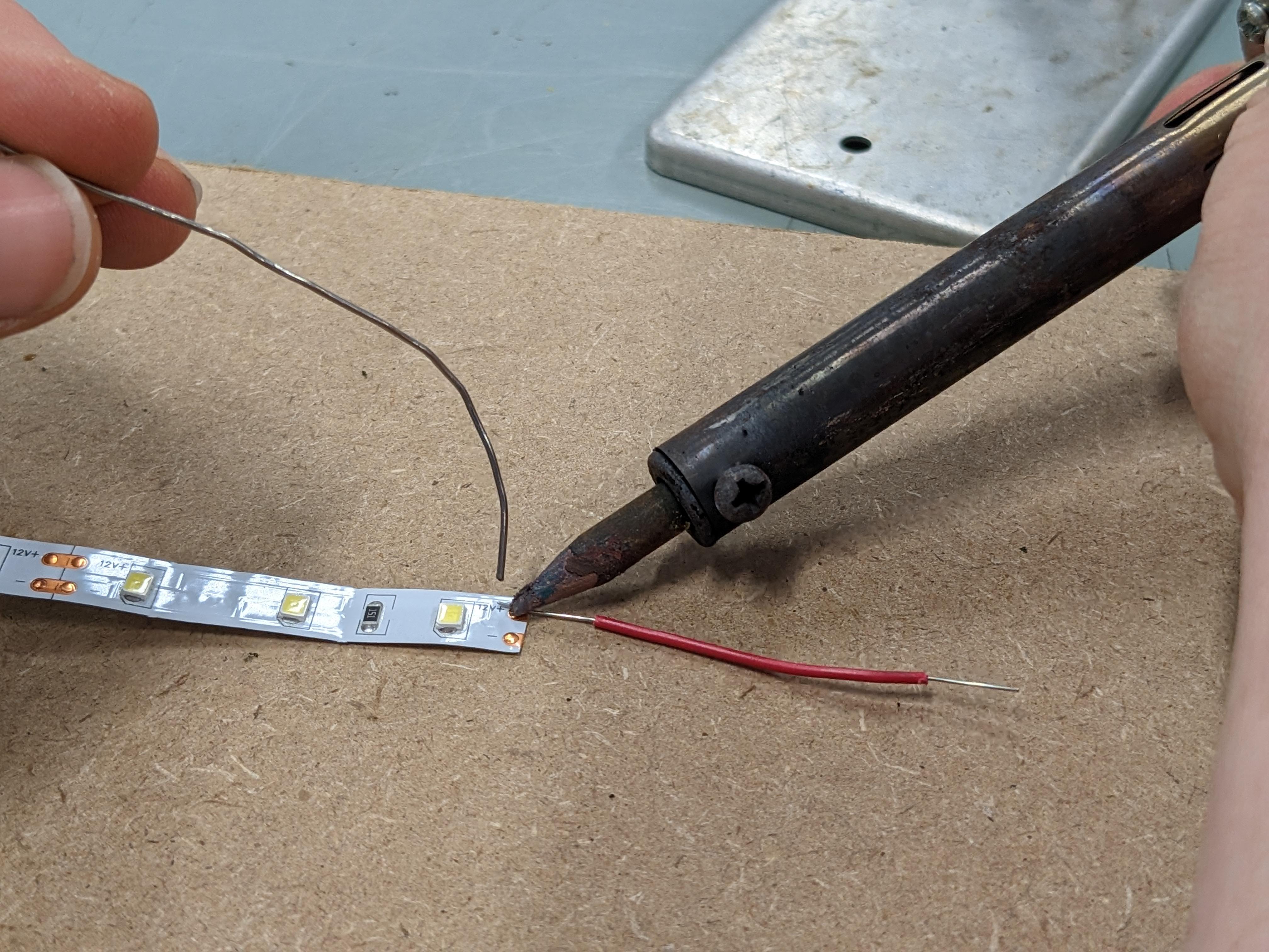

From there I worked through soldering the LED strips together piece by piece, checking to make sure the LEDs worked after almost every step. The struggle was real during this phase of the project.
Figuring out a repeatable method for soldering the small connectors of the LED strips to the wire was the challenge. I ended up having the LED strip laid out on a scrap piece of MDF as I pressed the wire down on it with the tip of the soldering iron.
The connections are definitely not the prettiest but they are functional.

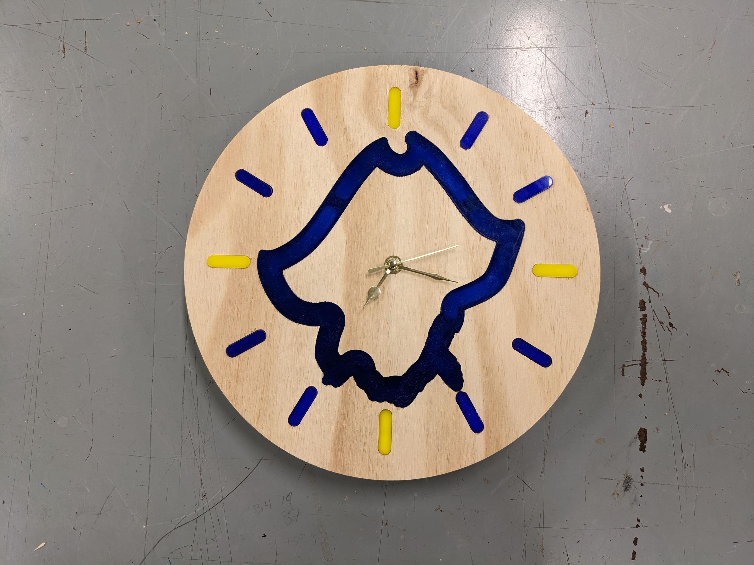

Step 7: Assemble
Before I went any further with putting this clock together I wanted to see how the acrylic looked with the backlit effect. I orginally was just going to make all the plastic inserts blue, but I cut out a couple of other colors to try and accent the quarter time marks. Without any further work done I think it looks pretty cool in the dark.
The biggest things I noticed when the acrylic was placed in the clock face was you could really see where the battery pack was at under the face of the clock and that the adhesive paper that was on the back of the plastic gave off a inconsistent effect on the lighting. I'm not going back to rework the LEDs to hide the battery pack, so I'm going to live with the bottom half of the pirate not being as bright. I did take the paper off the back of all the pieces and I thought it looked much better.
All that is left is the stick all these parts together. I originally thought about finishing the clock with a coat of white paint or a clear coat but decided against it. I thought the look of the bare plywood would draw more attention and allow the students to see what their clock might look like if they made one.
To install the clock kit I needed to drill the hole in the center of the clock face. Which was simple enough.
I used super glue to attach the magnets to the back ring and back of the clock face. I also used super glue to attach the plastic to the wood. This isn't the best option as I generally get some discoloration from the superglue on the acrylic plastic. If anyone has a better method for gluing plastic to wood without losing quality I'd accept the help on that too.

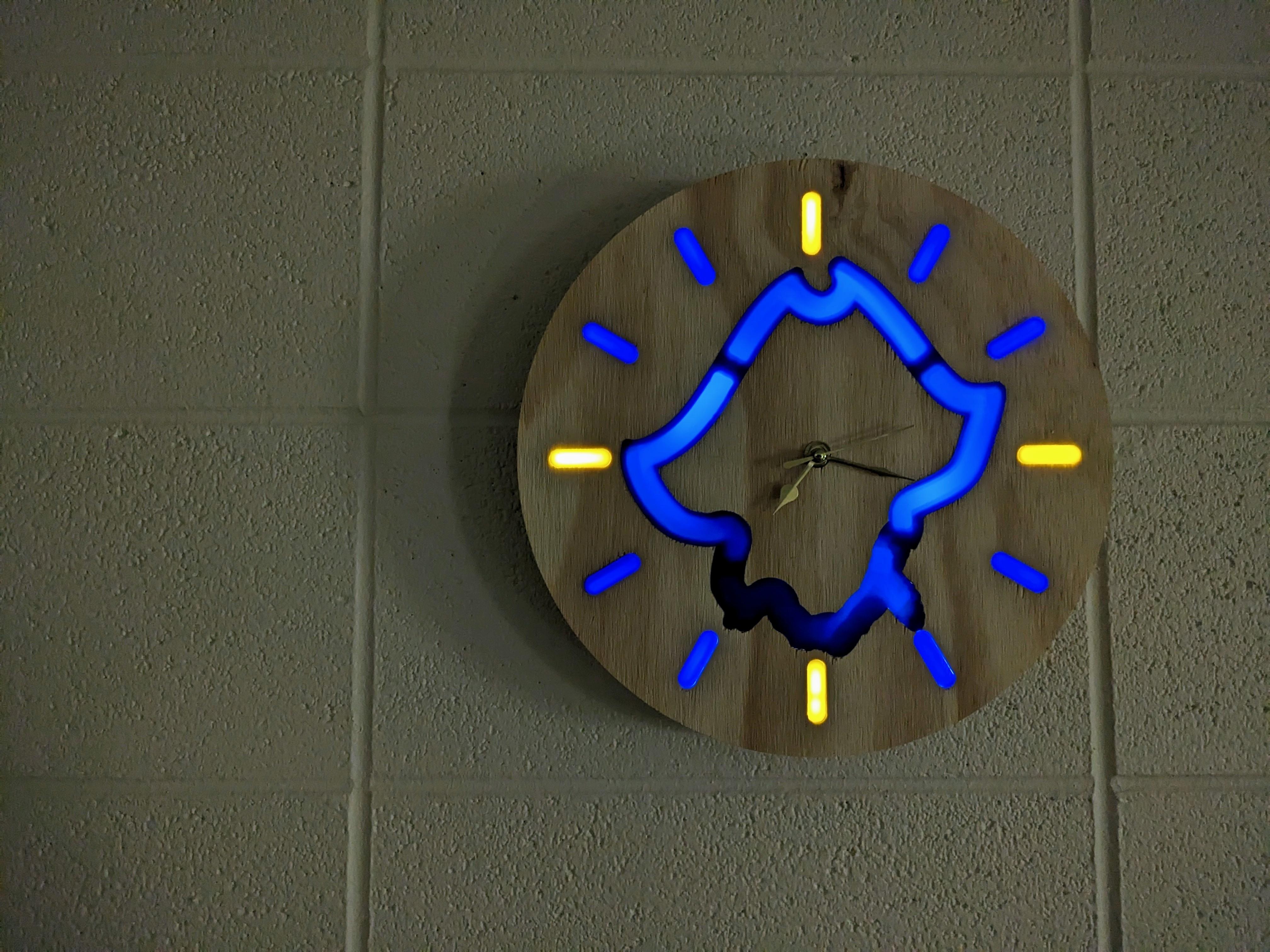

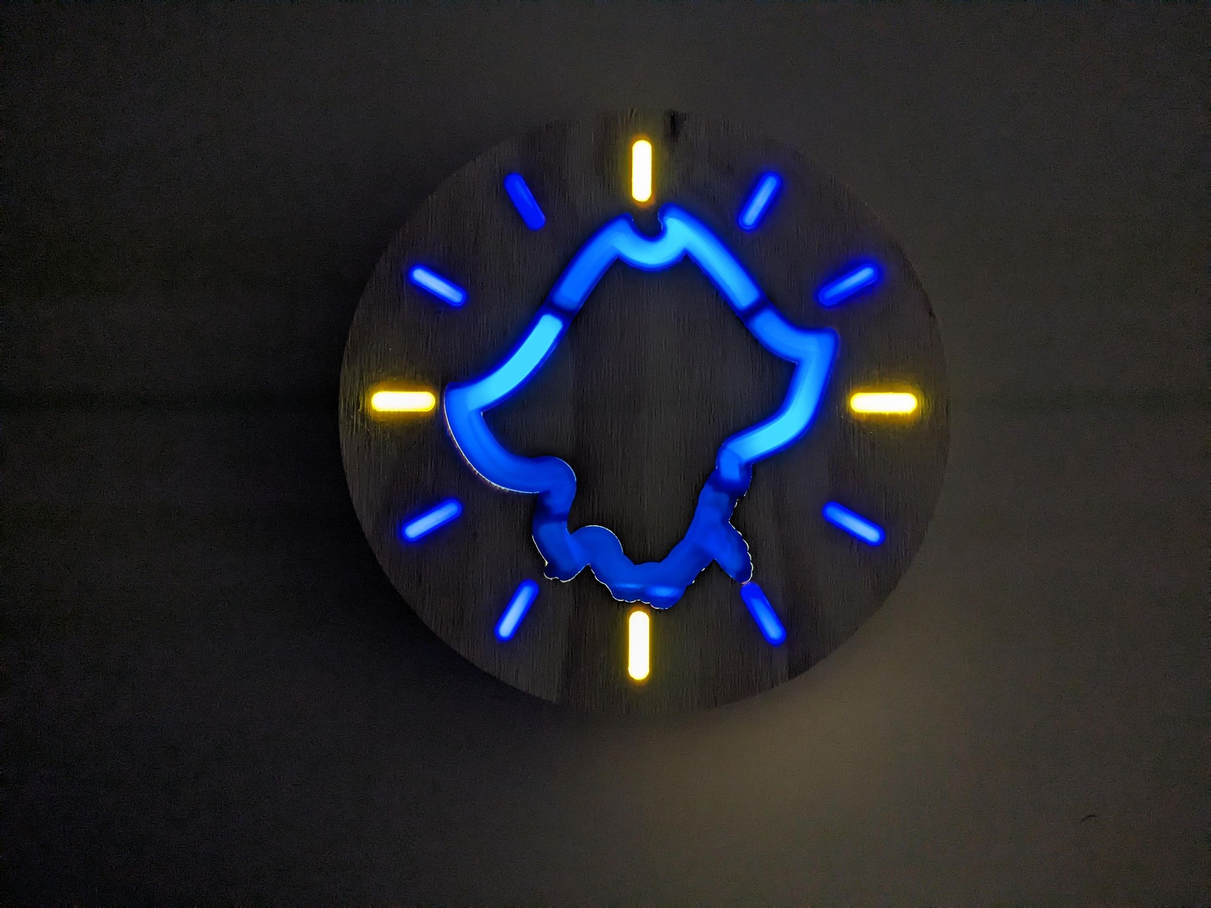

Put it all together and BAM!

A couple of things didn't work out as I hoped. The biggest issue was the warping of the plywood. I was hoping the magnets that I included would help with that, but the ones I had around were too small. If I used more magnets or bigger one in the design I think it would have worked better. Another sticking point for me was the clock kit. The one I used works fine but it is pretty generic, cheap, and flimsy. If I had more time I would have liked to 3D print some clock hands with a pirate theme to them.

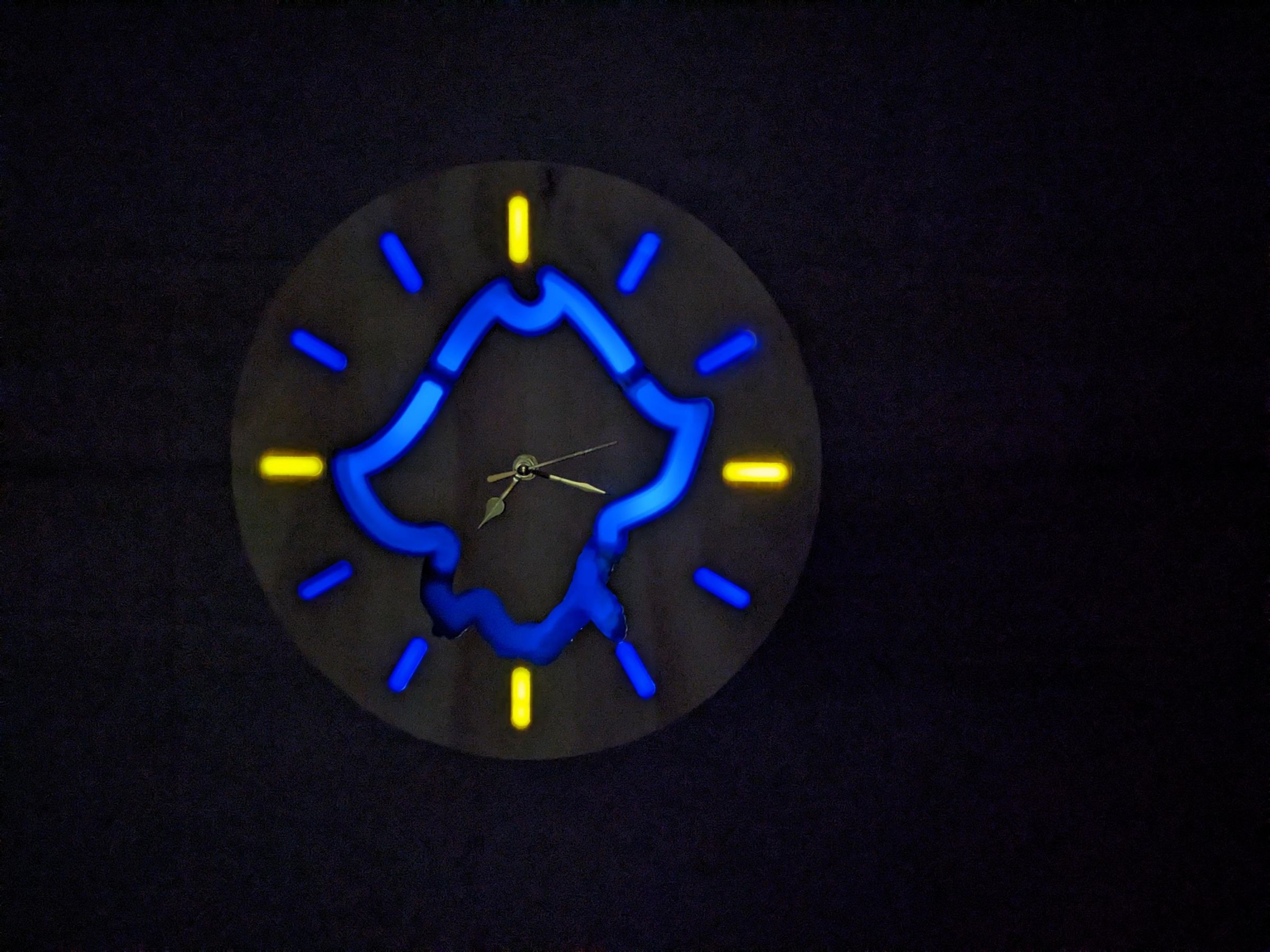

Step 9: Glamor Shots

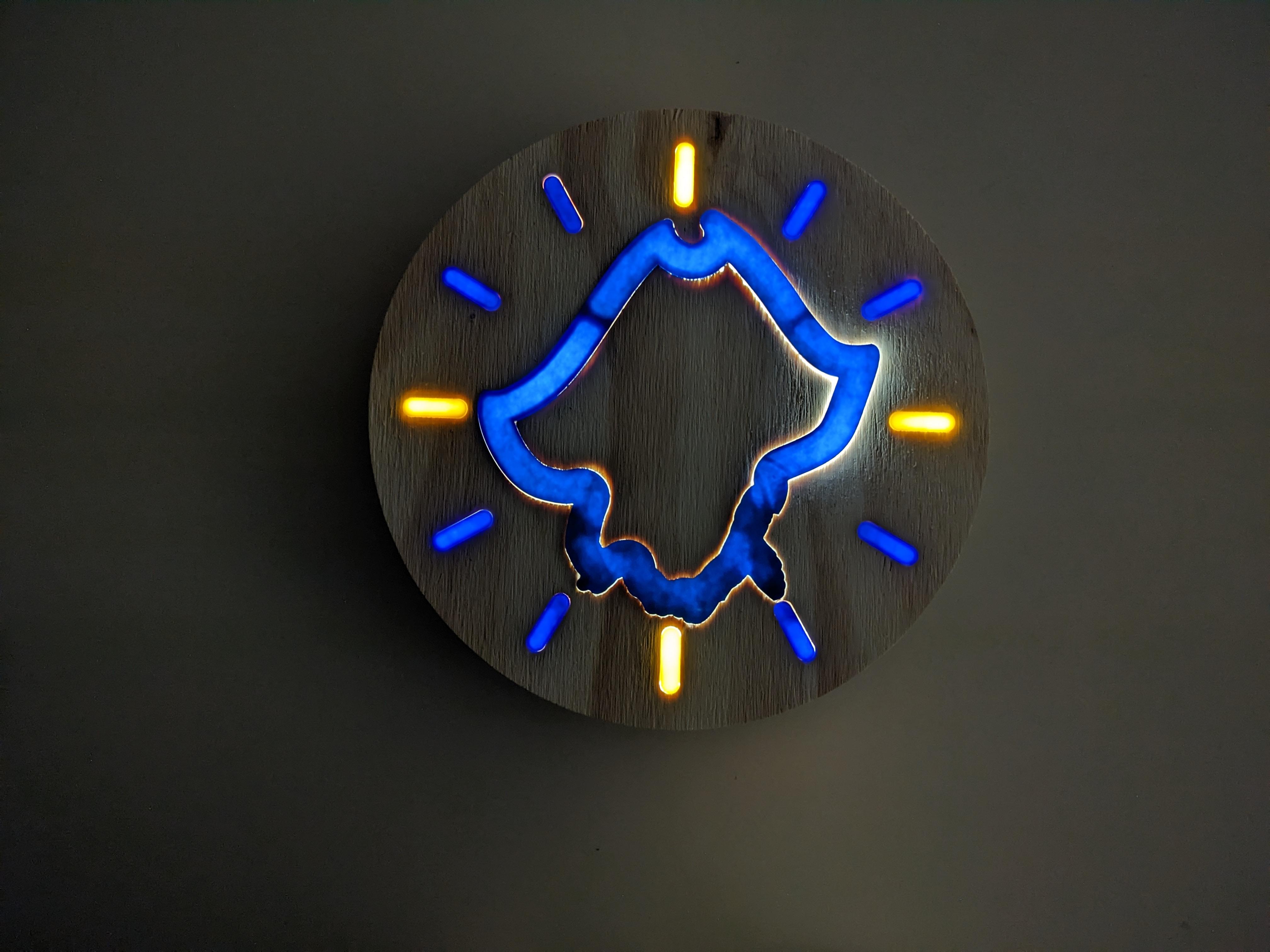

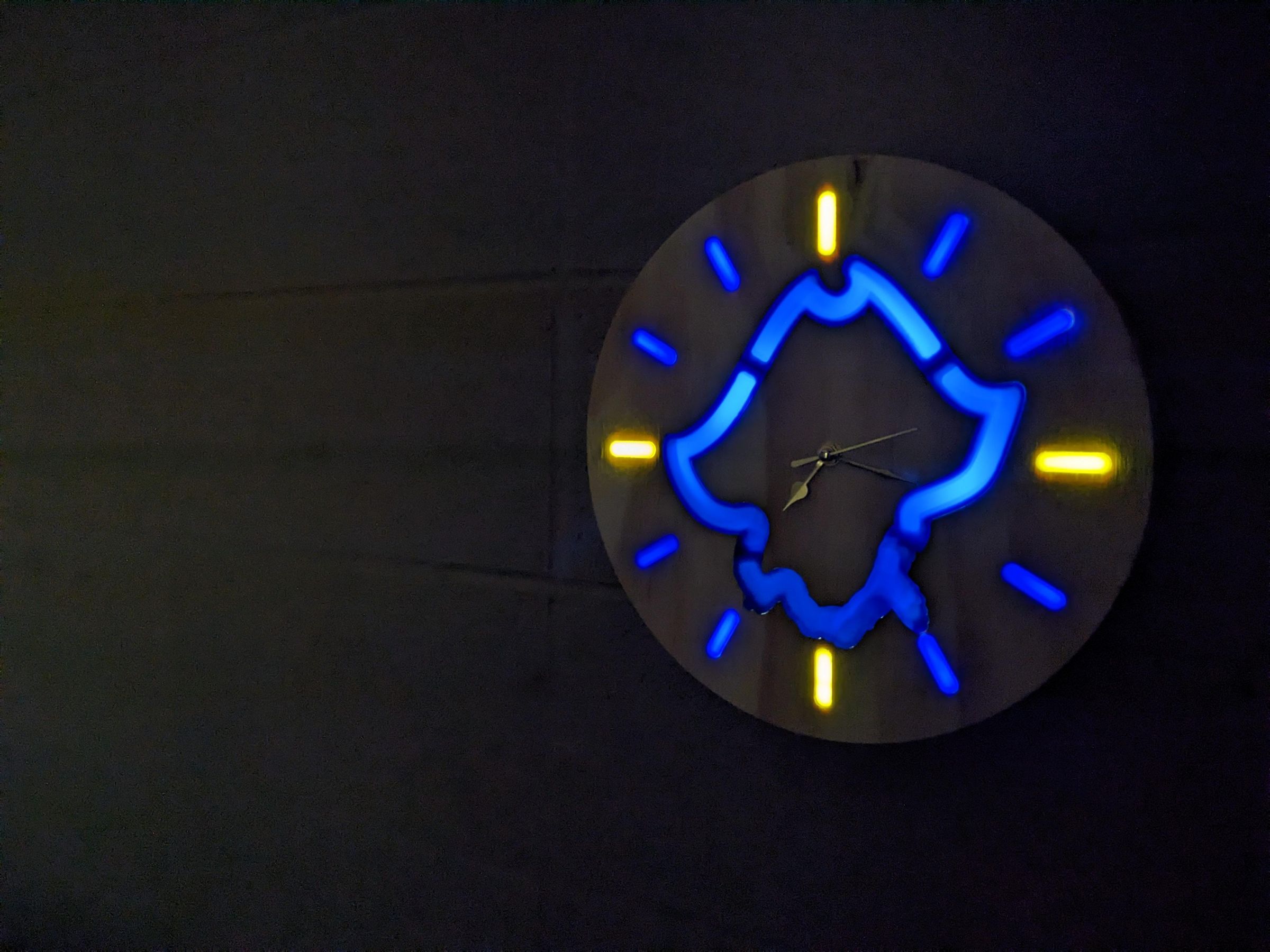

With the lights off this clock, in my humble opinion, looks awesome!
Ohhhhhh....
Ahhhhhhh.......
Pretty............
If I had more time for this build I would absolutely create this out of some nice hardwood, maybe a cool looking cherry. Other items I would address would be adding in an exterior switch that would allow me to turn the LEDs on and off without having to take the face of the clock off. And lastly, either purchase or figure out a way to illuminate the hands of the clock so you could still read the clock in the dark.
Overall though, I like the way this clock turned out and I no longer have to look like a moron to my students by pointing at a clock that isn't there.
