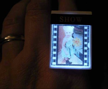

This is my prototype that I want to share with you. The picture is my lovely Granddaughter Kylee Bug, I will be making a mold of the frame and casting them, they will make cute gifts. You could layer images, advertise, show your art photos,or just show off the people you love.

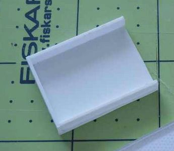

First cut the back piece out of the white polystyrene (.030") it should be 1 9/32" x 63/64" and then cut a piece out of (.020") clear the same size.
You will need:
(2) Side strips cut from styrene strip (.040 x .156) x 1.25"
(2) End piece cut from styrene strip (.040 x .156) x .980"
(1) Piece for top of image slide cut from styrene strip (.040 x .080) x .980"

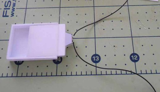

Use plastic solvent based glue to weld the frame together, glue the bottom strip on first, and then glue the sides.
At this point you should have 3 sides and a back.
You can sand if you like, but I wait till I have the front and top edge on.

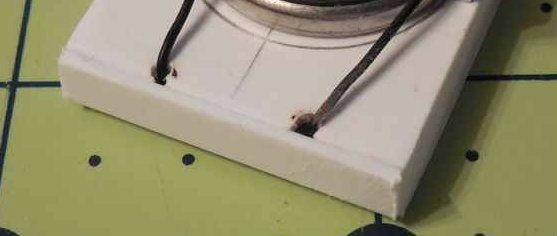

Now that that is done take a small piece of dbl stick tape and apply to the back of the module, place it in to the frame, take the soldering iron tip and burn out 2 little notches on the back top edge, like picture, this is where the wires will go.
Now with a little glue on the face edges, glue on the clear piece, next glue on the styrene strip (.040 x .156) x .980" This piece is glued only to the white styrene frame not to the clear, see picture, this gap is where the picture slide will go.

You will need to mark the back to center the battery, this is were the extra styrene strip (.040 x .156) x .980" is used, cut 2 little tabs the same height of the battery, glue one on both sides, like picture, next cut a strip to go across the top of battery. With the battery place in the center, I glued a magnet to the bottom edge, this is so the magnet will help hold, battery in its place and it is the contact point for the positive wire.
Bring the wires down beside the battery, cut them off just at the end, and solder a magnet on to the end of each wire.

OK so everything should be finished and if you are making this right now,bet it looks nice and please send pictures.
