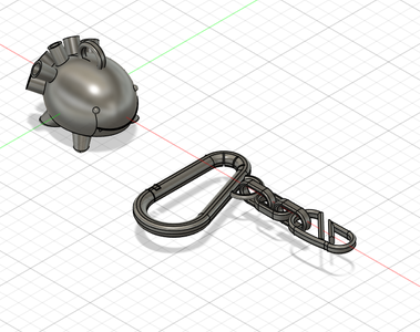

Introduction: Backpack Destroyman III
In this project I created a small figure of a creature from a game I occasionally play. It is designed to be able to be clipped onto backpack straps or any other area where something can be hanged off of. It decorates areas where things can be a little better.

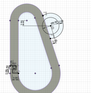

To create the clip, we will make a carabiner attached to the top. Make the following sketch on the top plane.
Step 15:
Offset the right plane so that it reaches the carabiner. Create a sketch on this plane, and make an 4mm x 4mm rectangle on the carabiner. Sweep it along the carabiner.
Step 16:
Make the following sketch on the right inner side of the carabiner. Extrude the ring downwards by -2mm, then extrude the sketch downwards again by -0.5mm.

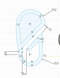

Step 17:
Chamfer the 2 bottom edges of the carabiner by 1mm. Do the following fillets.
Step 18:
Extrude cut the s shaped sketch and the three slots on the smaller end of the carabiner all the way through.

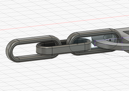

Step 20:
Create the following sketch. Then sweep it. Fillet the two side faces by .5mm. Use the move tool to create a copy of it, and rotate it by 90 degrees. Make sure the two parts are looped around each other but not touching. Then, create a third copy of the link and move it far enough such that it loops but does not touch the rotated copy. Add more links if you wish.

Scale the carabiner, the chain, and the loop together. For my project, I scaled them by a factor of 2. You can also scale the Destroyman seperately. I scaled mine to 1.3. After you finish scaling, combine the loop to the top of the destroyman. Make sure it's center is aligned with the destroyman's center.
Step 24:
Scale the final body and carabiner as needed to adjust to your purposes. For me, I scaled my carabiner by 2.00 and the body by 1.40. Ensure that the bottom layers of the two bodies line up if you are printing them together.
Step 25:
Attach the Destroyman to the chain by squeezing in the ring to the chain.
