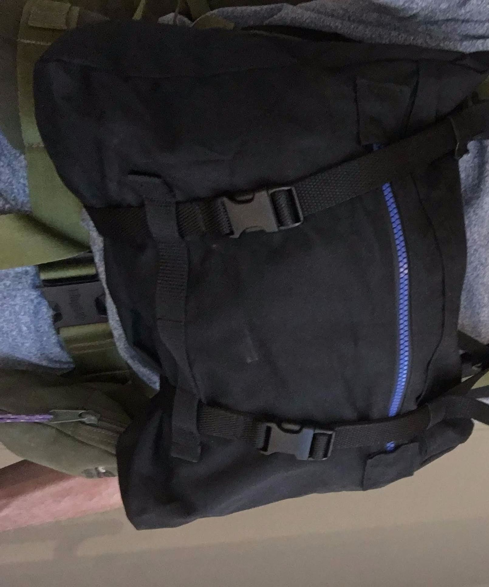

Designing the bag I took a rectangular piece of cordura to make the front and back of the bag i one piece. The design of the ends of the bag will form the bag. I formed the ends like assymetrical dropshape.
All sewing of zipper and transverse webbing must be done before sewing the ends.
I sew the transverse webbing to fit the longitudinal webbing. But tight enough to stop the female buckle-ends. Doing this will allow me to release the buckles and let the frontbag hang in the male buckles in the carabiners.
When the webbeing and the zipper was done I turned the inside out and sew the ends. Before turning it back i waterproofed the sewings with seamsealer.
