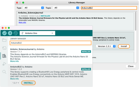

Step 4: Download Arduino Libraries

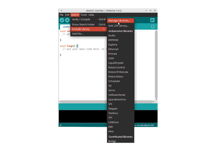

Before you jump into the code just yet you need to download the latest version of Arduino IDE online if you have not done so already.
Then when you open up the Arduino application, you will see the tabs at the top.
Head on over to Sketch.
Then Include Libraries.
Then Manage Libraries.
You can download many libraries from here but for this project we will be looking to include the library titled. "Adafruit_VL53L0X"
Here is the link to it as well.
VL53L0X library for Arduino - PololuGitHubhttps://github.com › pololu › vl53l0x-arduino
