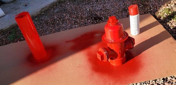

Step 7: Paint
Don't forget to remove any barcode stickers and to lay down ground protection before painting. Paint the PVC pipe in several coats, allowing the paint to dry between each coat to prevent streaking.
If you want to secure a poop bag dispenser, glue it on with construction adhesive after the final coat of paint dries.
