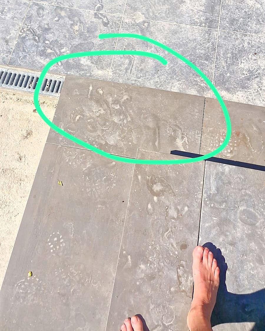

That was again a mistake. Apparently, when you want to use mortar to place tiles, you should add some dry mortar powder less than 5 minutes before you place the tile. I did not know that...
Some of my tiles had very limited space under the tile (because my layer of blocks was a bit too high in some places), so there I used glue for tiles. I added too much water, my tiles were a bit wet and I only put the glue on the blocks and not on the tiles before I put them in place. That was all wrong. The glue had to be thicker, the tiles had to be dry and you have to put the glue on both surfaces. I did not know that either...

Step 15: Two More Tiles Coming Loose
I carried the rebar netting to the concrete floor of the terrace and the combined weight of me and the netting was too much for two of the tiles of the stairs and they came loose too. So I glued them back in place again.
Step 16: View From the Security Camera
In the evening after I went home my friend looked at the images from the security camera to see the progress of my work. He sent me a message with this screenshot and asked what happened. Two large stones in the blue circle were upside down. I told him that I checked all tiles and stones to see if they were coming loose too and these two indeed came loose.
You can see the red and white tape on top of the two tiles that I glued back earlier that day. Later that evening my friend went there in person, tried some more tiles and accidentally also hit the two tiles that I just glued again and since the glue did not set properly yet, they came loose again too...

Just before the guys arrived with the concrete I decided to remove all tiles that might come loose again later by prying them loose with a crowbar.
Step 18: Tips From the Expert
Here you see another screenshot from the security camera. The guy on the photo has many years experience in construction and he came to help me with the tiles to make sure they were never coming loose again.
We first used a primer (orange) to help the glue stick even better. Then we used a professional glue, put it on both surfaces and made sure the tiles were dry.
Now the tiles did not come loose anymore.
