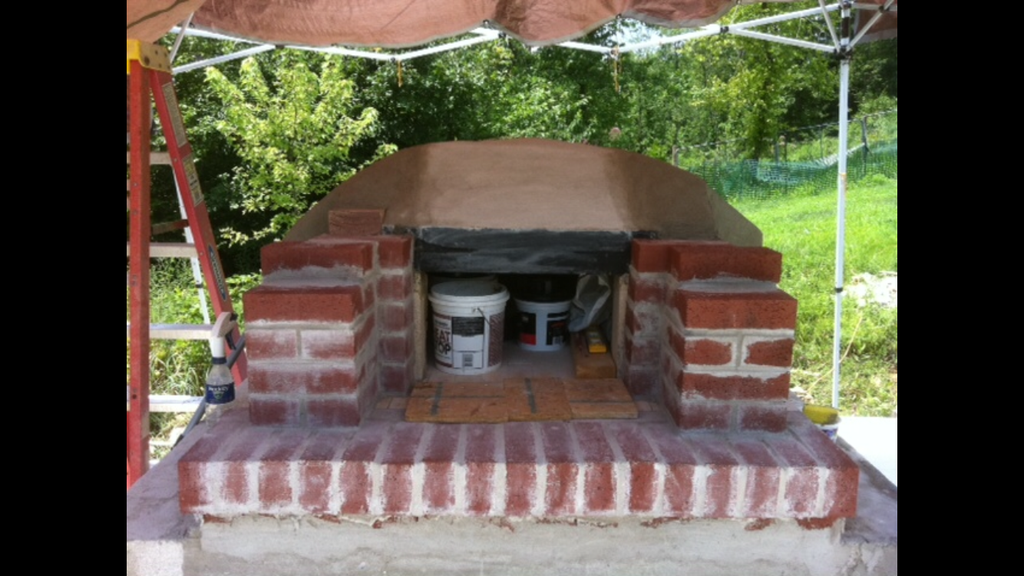

Step 9: Step 9: Covering It All Up
Before you go on to the outer layer, go around the whole oven first to fill in any cracks, holes and gaps you may have otherwise missed with more mortar to ensure a perfect seal.
You may want to cover the cinder-blocks as well, you only need to use common waterproof cement mortar and red bricks as it won't be in contact with much heat. This is purely for ascetic reasons and is completely optional.
Covering up the oven with cement is a bit more difficult. The cement mortar needs to be heat resistant as well or it will crack, and needs to be made for the outdoors to withstand rain, snow, sun and anything else mother nature uses to punish us.
Test the oven by lighting a small fire in it, this will help the bricks settle and also help harden up any mortar between the bricks that hasn't hardened yet.
Instead of using a trowel, I used my gloved hands to apply it, as the oven is a curved surface and getting an even and well spread amount is difficult. The cement needs to be be wet enough to spread around, but not too runny so it doesn't slip off the curved sides and fall to the ground.
Apply between 2-4 coats on top of the oven to fully seal and protect it, keep in mind it too will take a long time to dry. Use your cement trowel or sponge to smooth the final layer. You may also want to use the angle grinder with the masonry wheel or a sander, but be aware that it could fling large chunks of partially hardened cement towards you, so take appropriate safety measures.
You can paint the outside to give the whole oven a finished look, be sure to use paint made for outdoor application to avoid cracking and flaking.
