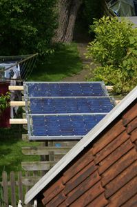

As that the OK-4 inverter hasnt got a build-in display to see how much output it gives I needed a separate production meter.
A guess what, I was also not prepared to pay the full solar panel world price for this neither.
I went to a local DIY store and bought an ELRO M12 Power Calculator, which is actually mend for calculating the usage of electrical appliances but works also fine to calculate any solar production (this calculator is working both ways it can give and take electricity from the net).
And this calculator plugs straight into the mains power supply with no difficult wiring (thats what we need).
Factory figures gave me that each cell gives 0.5V x 6A = 3Wp, but this in the perfect circumstances. For a whole panel this would mean 28 cells x 3Wp = 84Wp.
But from previous gained knowledge I know that this is always given as an to optimistic figure and that around 20% less production will be achieved in real live.
In this case this would mean a true expected production figure of 67Wp.
My panels are certainly not facing the optimum way, but this is for now also not the meaning (as silly as it sounds).
The panels are placed at a 10 degree angle (instead 35) and not exactly facing South.
But where they are placed is a temporary installation with the reason that I want to see how theyre behaving in real weather with cold temperatures, lots of rain and a blasting sun.
A real setup will come in the near future.
Taking all of this in account the panels are producing 15V x 3A = 45Wp each.
Concluding that the voltage of the cells are used to the maximum.
The amperage can go higher, this can be done by changing the angle of the panels more into the sun, but is currently not possible due to their placing location.

If I see that voltage wise the maximum output has been reached, I can say that the panels are working fine and do the give so far an average of 500Wh per week.
Now the critics among us will say that this is nothing, but given that the panels have the potential to produce more as if I only change the facing/angle, the panels are smaller than a standard panel plus it are only 3 panels they do fine.
Plus my aim was to overcome the standby appliances in the house so you can say that I succeeded.
Apart from the durability (this test is currently on going), I can say that a home made panel is working just as good as a panel bought in a shop.
