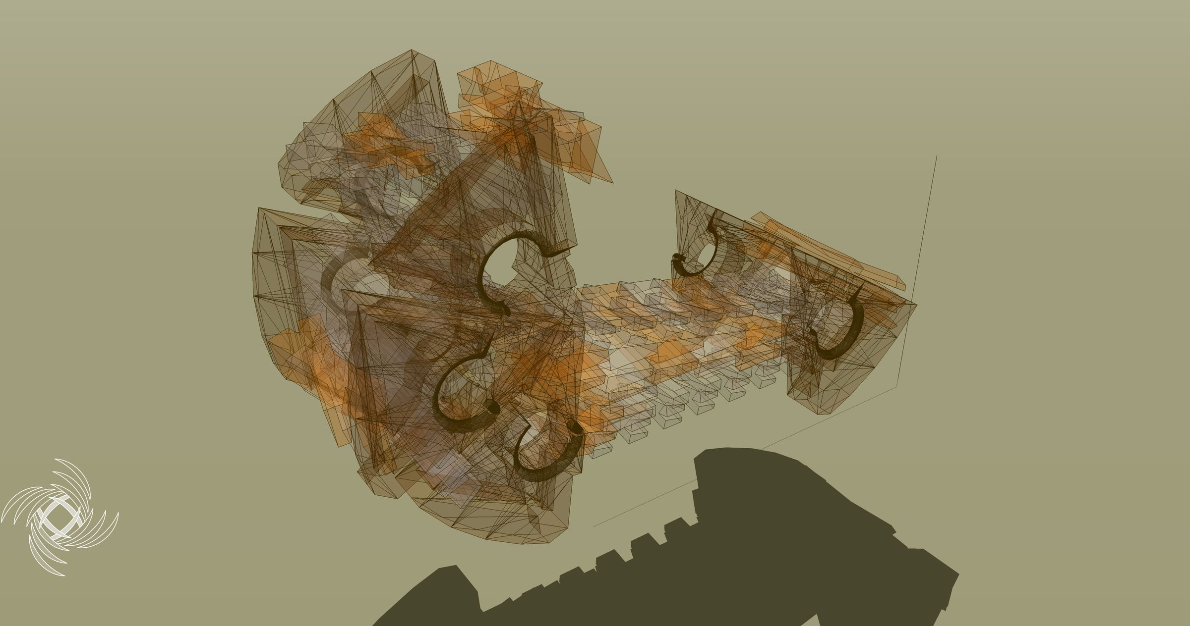

Step 2: Build Solid Things
manifold assemblages mean you are water tight.
it means you have solid groups.
once you get them that way, they can be forced together at will,
and the end result
after processing them into STL files,
is a reality ready to 3D print
So take the time and do it right,
make sure when you click on an assembled group in Sketchup, it says "Solid Group"
use your zoom, examine the shell.
Use plugins like Fix Solid, Manifold, STL conversion by Jim Foltz, Grow, and Fredo tools like reverse orient face.. etc.
the magic really happens when you get to "Solid"
build away

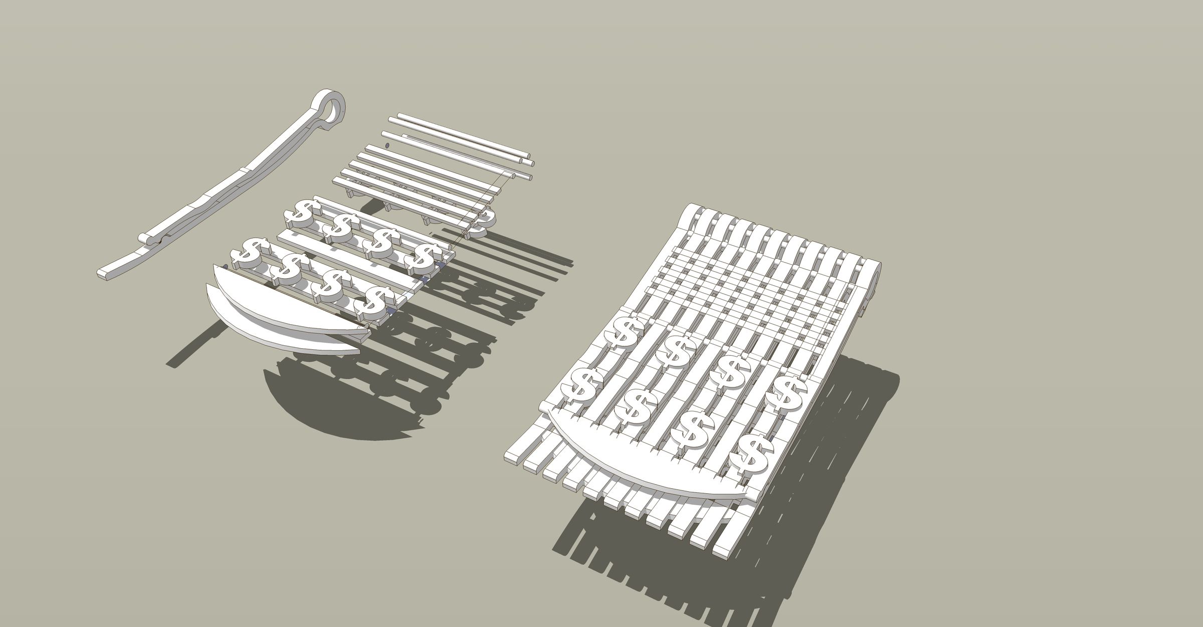

Step 4: manifold Assembly Production II
more digital production drawings
at this point the robot's chassis is complete and some cross bracing has been added
in any given model, it is good to stay near the fence line of minimum widths.
Think of building up shells instead of bulky mass, create a jack o lantern, not a pumpkin.
Lowering volume lowers your printing costs
