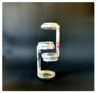

Baking Soda and Super Glue can also be used to join things together. Here are some examples:
- Vertical Garden (Joining the plant containers together)
- Tensegrity model (Attaching the string)
