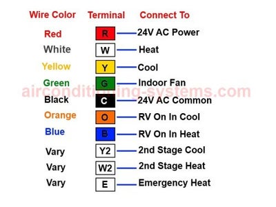

Find the part of your unit that has exposed circuitry, and look for screw terminals with labels like "R", "G", "W", "Y", and so on. You can also just follow your existing thermostat wiring. These designate industry standardized wire colorations for thermostat control wiring.
Connect a wire to "G" for green, and a second wire to "R" which should be the source wire for 24VAC. You can confirm this with a voltmeter, although you may need to defeat a cover interlock with your hand to do so. Guide the two wires to the outside of your unit by the same path your thermostat wires take to come in.
