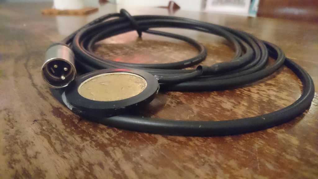

    Hello. I came across this project while searching for diy contact mics and really want to try this. I'm new so forgive the newbie question.
    The only part I don't understand is wiring the cables (XLR and microphone). Are we choosing to wire just one of the cables (so choose the XLR cable or choose the microphone cable depending on the needs) or are we wiring the piezo and both of the cables together? I understand your wiring schematic for one cable but not wiring both. Reading the instructions hasn't clarified and none of your pictures show the cables in detail. Can you clarify?
    0
    chrlilje
    chrlilje
    Answer 3 months ago
    Hi nortok00 - I am not sure I fully understand your doubts, but i'll try to clarify.
    I use XLR cable and microphone cable in a confusing way I think.
    A microphone cable usually have an male XLR plug in the end.
    In the other end of the microphone cable, we attach our two piezo disks.
    The XLR plug goes into a mixer, typically, or directly into an active speaker sometimes.
    You will use 2 piezo disks for 1 microphone cable with 1 male XLR plug in the end.
    I have attached an image of the finished piezo, hopefully this will also clarify.
    Do let me know if you have further questions, and I will try to answer as good at I can.

    nortok00
    nortok00
    Reply 3 months ago
    Thank you! Now I understand (or hope I do). So it's just one cable I'm buying and not two? That would make sense. In your list of things needed I thought it was a microphone cable and an XLR cable and that had me confused as to how these would be wired to the piezo.
    0
    chrlilje
    chrlilje
    Reply 3 months ago
    You just need 1 cable. The microphone cable has 3 conductors inside. A shield (ground wire), a red and a white wire. Those are the ones I refer to in the drawing :-)

    What is the black washer looking piece on the outside?
    0
    chrlilje
    chrlilje
    Answer 3 months ago
    A little late reply, but the black plastic disk around the piezos are just the way our piezos came from the factory. They have no electrical purpose, but I could imagine they make the piezo a bit more sturdy.
