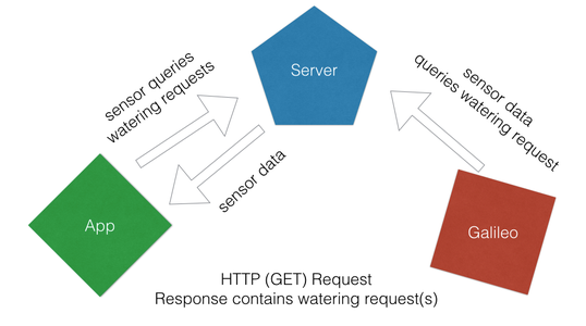

Balcony Gardener consists of 3 basic parts.

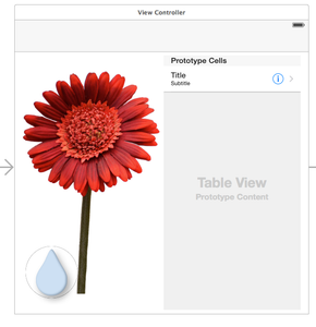

On the one hand, we have 2 Apps, one for Android and one for iOS, polling the sensor data from the server and displaying it in a table and also showing the user a nice chart containing the last couple of hours of captured data.
The probably most important part is a simple php server in the middle. It connects the app and the Galileo, saves the sensor data in a SQL database, which can be queried using predefined requests.
Near the plants, you put your Galileo, which updates the sensor data on the server and fetches manual watering requests.

The simple app we developed contains a watering button which you can see on the bottom left side. If you press it, it sends a request to the server which recognizes it and saves it locally. When the Galileo sends new sensor data to the server, the servers response contains whether it should water now or not. Like that, we have no direct communication from the server to the Galileo which spares us the fight against dynamic IPs, etc.
