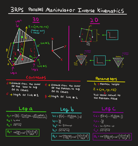

The robot is a 3RRS parallel manipulator. This is essentially a 3DOF platform with 3 legs each having 2 two rotational joints. Extending or contracting each leg will result in the platform being angled in a different way. This is done by each stepper motor. My biggest considerations when designing the balancer was to have sleekness and simplicity. For sleekness, I ensured that the electronics and most of the wires were well hidden. For simplicity, I decided to use 3 motors (3DOF) rather than the 6 motors (6DOF) used in version 1. Weighing the cost-benefits, I also chose not to use position encoders with the stepper motors. Using encoders would only eliminate the need to have the machine start at a common position. Without them, you simply just have to push the platform down every time.
Inverse Kinematics
The machine is able to angle itself through the use of inverse kinematic equations. These equations calculate the position to move each stepper motor in order to achieve the desired platform orientation. I derived these equations myself mainly using vector calculus, trigonometry, and lots of patience. The equations are fully parameterized meaning that they would work with any 3RRS parallel manipulator of any shape or size.
