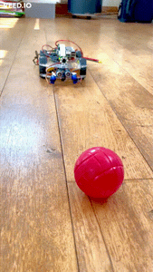

There's been a lot of talk of computer vision and artificial intelligence recently with the developing world becoming more digital day by day. This got me interested in computer vision especially, inspiring me to create a ball chasing rover car that identifies, and chases a red ball, and once in range, attempts to propel the ball using the servos at the front.
This project relies mostly on the Raspberry Pi, which processes the incoming video, identifies the ball, and controls the speed of the motors in relation to the position of the ball to chase it. The Arduino has a completely independent connection of electronics, that measures the distance of the ball from the rover, displays that distance using the Neopixel ring, and when too close, activates the servos.
This project was a lot of fun to do and i hope you like it.

Step 11: Success?
Once you press enter, your robot should start moving. If there is a red ball within its view, it should turn and follow it. Once it gets close, the servos should activate. You will have to alter some settings in the python code relative to what the lighting is in your area and how red and big the ball is to make sure the code can correctly identify it. To check if your code is identifying the ball correctly, include the lines of code beginning with "cv2.imshow" to get a live feed of what the camera sees and what it thinks is the ball.
