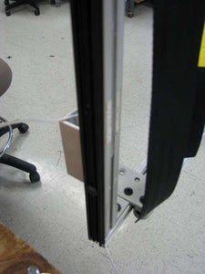

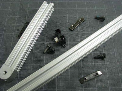

Step 3: Assemble Target Frame
Cut 1010 T-slotted Aluminum Extrusions into four bars that are 36” in length. Align the bars so that the outside vertical height is 38” while the outside horizontal length is 36”. The inside vertical height should be 36" with an inside horizontal length of 34". See diagram.
Step 4: Attach Joining Plates to Frame
Attach a four hole joining plate to the two top corners of the frame and securely screw into place. Attach two 2 hole standard transition inside corner brackets to the bottom corners of the frame and screw into place.

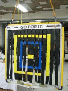

Step 5: Assemble Target Shroud
Cut fourteen pieces of 1.75” seat belt material that are 35” in length (other material can be used); cut another piece of seat belt material approximately 34" in length and vertically align the fourteen seat belts to the horizontal seat belt and sew horizontally across the horizontal seat belt to get an even line. The vertical seat belts were placed 1" from the bottom of the horizontal seat belt.
Step 6: Attach Shroud to Target
Use a fabric hole puncher to create holes in the seat belt material consistent with the spacing of the economy T-nuts in order to screw the fabric into the 80/20 frame. Then, attach the shroud to the target with economy T-nuts and screws across the horizontal seat belt with the attached vertical straps– use the two hole washers for the ends for more support and use the one hole washers that are equally spaced across the middle of the horizontal seat belt material.

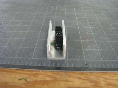

Step 7: Assemble Housing for IR Sensors
Create IR sensor housing out of 1x1” square aluminum that has one open side. Drill holes for both the sensor and the mounting screws. The hole for the wire was 7/16" and the holes for screwing to the side of the frame were 3/8". See example.
Step 8: Attach Housing for IR Sensors to Frame
Screw the housing of the IR sensors directly to the frame of the target using screws, a double economy T-nut, and washers. See example.

Step 11: Attach Hanging Eye Bolts
Screw eye bolts directly to the top of the frame approximately 3.5" from the edge of the frame on each side. All purpose rope was tied to the carabiners and the carabiners were hooked onto the eye bolts. The other side of the rope was attached to a hook for hanging.
