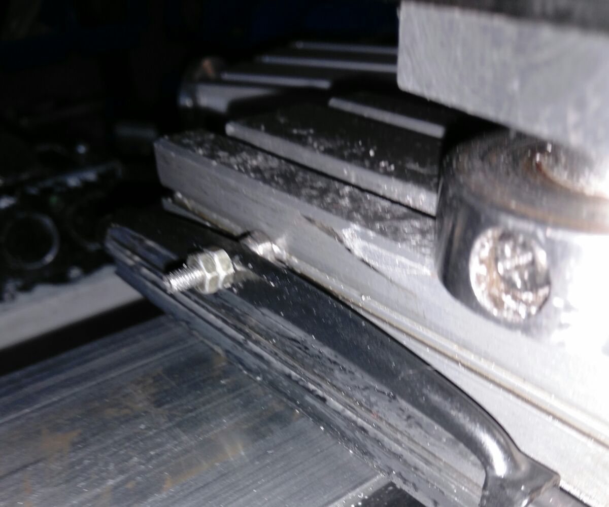

Instead of using hex nuts and wrenches, allen keys and cap screws, I use lock handles as much as possible and have made quite a few of them for my tool posts and other ancillary attachments for my Taig lathe.
At first I simply used a short cylinder as a head, tapped at the bottom with a hole appropriate for the purpose for which the handle is made, drilled a cross hole through the top part of its body, and inserted a short length of thinner steel rod (say 5mm) into the cross hole as a lever. This works well but it looks rather crude and is not quite ergonomic. So I replaced the cross rod with a tapered handle tipped with a ball to give it a better look and feel, and angled up by a few degrees to be more nicely held.
I made the first few without any plans or set dimensions and just improvised on the go. I find it particularly difficult to attach the handle to its head, especially when it is also angled up and not stand at right angles to the wall of the cylinder. The resulting handles vary in quality and size. Several did not even pass my very lax visual inspection and had to be discarded.
