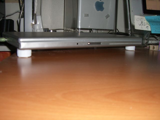

1 bottlecap leftover from your Laptop stand from 4 bottlecaps
