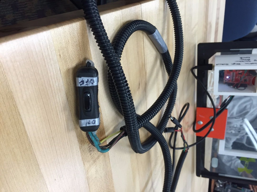

Step 5: Switch (Power Source)
We had to create a switch for our system to start and stop on the person's command. We had to strip wires and connect them to longer wires in order for the switch to reach the player from the backboard which is 10 ft. high. We had to put a middle wire which is around 6 ft. In order to successfully have the electricity run through all the wire, we had to solder the copper wires together. Then we had to insulate the open wire with a shrink wrap as a safety hazard.
