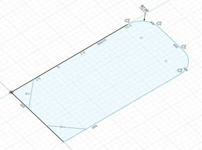

Step 1: Base
Select Sketch on the top plane, make a 2-point rectangle and using fillet, curve its edges.
Step 2: Fillet
After filleting and sharpening the edges, this is what it will look like

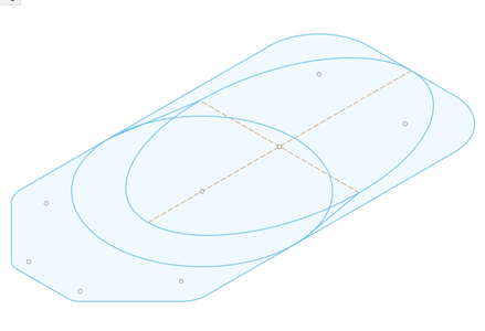

Step 3: Defining the Shape
Make a circle and an ellipse

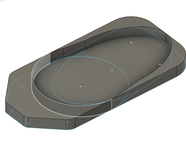

Step 4: Extrude
Then extrude the edges

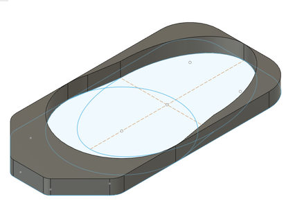

Step 5: Extrude the Bottom
To not make it clear from the base, extrude the base by a small margin

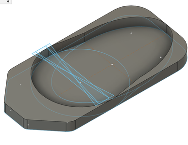

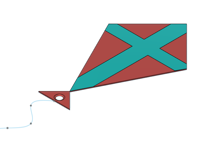

Step 6: Making the Straps
Create an offset plane from the bottom of the shoe that is 1.2cm above the base. Create a rectangle and make diagonal lines

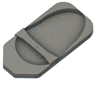

Step 7: Extrude
Extrude it and you're done!
