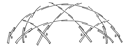

- Pentagons:
- Connect two B crosses as shown in in the diagram.
- Add two more B crosses in the same manner as shown in step A.
- Add the fifth B cross between the untied legs. In order to insert this cross, all crosses will be twisted so that a regular pentagon is formed.
- Repeat until you have six pentagons

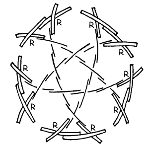

- Complete five of them with two R crosses at adjacent sides
- Triangles:
- Same as above but use three R crosses to make a regular triangle
- Repeat until you have ten triangles
