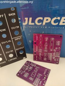

It's nice to have separate modules for separate functions in our modular synthesizers, but we always have to deal with strict space limits. This sometimes turns into an opportunity, like in this very case study, where two multimode filter boards in different configuration (low-pass and high-pass) where combined with a final audio stage voltage controlled amplifier to give rise to a 16HP combi module.
In this Instructable I will show you how to realize a full, sort of "filter amp" combined module for modular synthetizers. I will share with you both main boards PCB's Gerber files and those for the dedicated front panel so that you can have them directly manufactured by Professionals of the sector at the best price.

Step 1: Filters Stage
In a previous Instructables I showed you how to realize a multimode resonant filter based on the one Korg realized for the MS20 (MKII). An iconic filter, with a non neglible part of it's charm coming from the voltage controlled high-pass resonant circuit placed before the low-pass circuit in a sexy, resonant bandpass configuration.
I had the opportunity to make some minor modification to that circuit (in particular some components value has been changed since), but this work is mainly a PCB redesign in order to have two of these boards behing the same front panel.
Being that PCB manufacturers realize such PCB's in multiple of 5, having the possibility to reuse the same circuit for both high-pass and low-pass configurations makes this filter the best candidate.
The filter mode can be easily selected by grounding the low-pass input pin for a high-pass configuration, or the high-pass input pin for a low-pass configuration (see attached pictures). Simple as that!
Please, notice that the filters PCB is full featured, with pads to solder an input, an output and two control voltages (CV1's level being adjustable by the dedicated potentiometer). The PCB, in other words, is a full featured stand-alone high pass or low pass filter despite being part of a combined module.

PS: isn't that purple PCB damn nice looking? :)

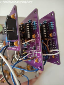

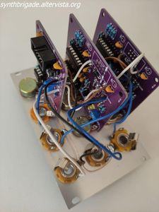

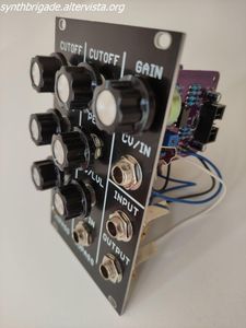

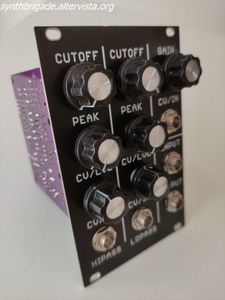

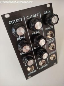

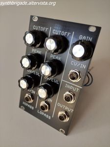

Step 3: The Combi Module
Grouping three modules into one has it's advantages in terms of HP occupied in the case. These three components are often used in series one after the other (or at least this is how I almost always end with), so grouping them was a logical step to save some room for other modules.
The module is made up of three printed circuit boards (two of which are unique) and a faceplate. The unique PCBs are the multimode filter board and the voltage controlled amplifier board.
The same filter PCB is used in two different configurations for the high-pass and low-pass resonant filter. The populated filter board will work as low-pass by shorting to groud the high-pass intput pin (HPIN), or high-pass by shorting to ground the low-pass input pin (LPIN).
Boards are intended to be mounted perpendicular to the aluminum front panel. Jack connectors are wired to the appropriate, pre-labelled, pads on the board.
Boards sequence is: hi-pass filter, followed by low-pass filter, followed by VC amplifier.
Inter-boards connections are:
- faceplate jack connector "INPUT" to high-pass filter "HPIN"
- high-pass filter "OUT" to low-pass filter "LPIN"
- low-pass filter "OUT" to VCA "IN" input
- VCA "OUT" pad to "OUTPUT" jack connector on the faceplate.
The VCA board has two control voltage inputs. CV1 is connected to a voltage divider ("CV_LEVEL" potentiometer) which is left out of the board in the combi configuration. This means that if you connect the CV jack connector on the faceplate to pad "CV1", it will not work. Use pad "CV2" instead, which is directly wired to the amplifier circuit.
Pre-drilled holes are dimensioned for 1/4" jack connectors, not the eurorack 1/8" standard connectors.
You can download all Gerber files at THIS link (Github). You can have all PCBs manufactured at the best price at THIS link (JLCPCB). Take care of the PCB material you select: aluminum boards are the best choice for the faceplate and cost the same as fiberglass boards!
