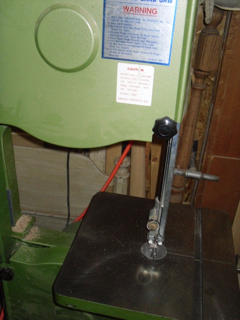

To ensure the jig remains a constant distance from the band saw blade, it is necessary to utilize the miter track on the band saw tabletop. On the band saw I use, the miter track is a hair under 3/4" wide.
Using the planer, ensure one edge of my intended miter guide piece is straight, then set the table saw to rip this piece to the desired 3/4" width. Using the radial arm saw, cut the miter guide to the desired length dimension, which is roughly 8".
Now, try to dry fit this piece in the miter guide. Expect a tight fit. If it is too tight to permit easy sliding, use sandpaper on the edges to make the fit less tight.
With the miter guide now able to slide smoothly in the track, it may be necessary to decrease the thickness of the miter guide such that it is not thicker than the depth of the miter track. If necessary, use the planer to knock some of this excess thickness off.
The miter guide should now slide smoothly and not protrude from the table of the band saw. It is not a problem if the guide is thinner than the depth of the miter track.

The width and length of the jig's body is not a huge concern, just ensure the thickness of the board is at least 3/4" and the board's length to be at least the distance between your band saw's blade and edge of the table. A wider board will accommodate a larger variety of wheel dimensions.
I chose to cut the jig's length to match the distance between the band saw blade and the edge of the table. I left the other dimensions to those of the original pallet board.
