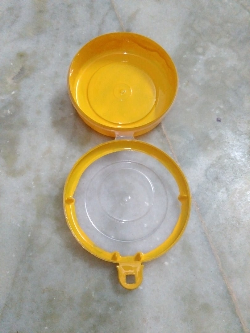

1.Plastic bangle box-1 no.

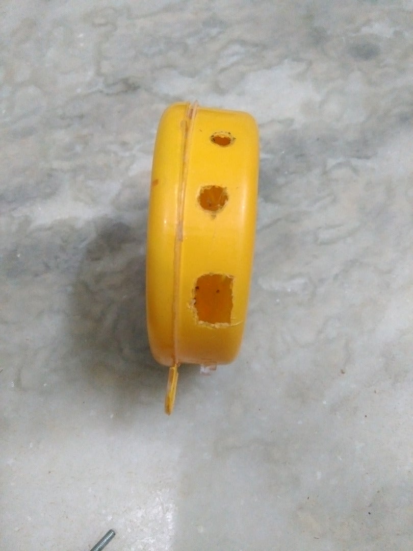

6.DC jack-1no.

9.Switch - 1no.

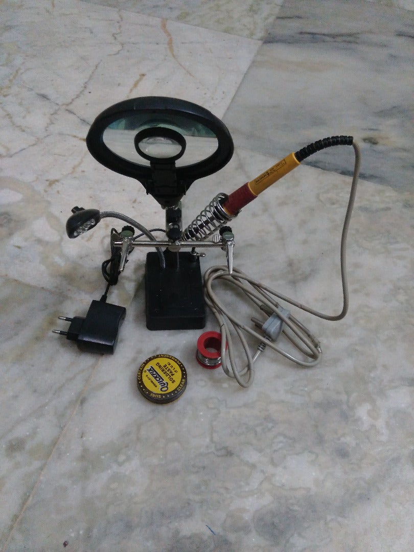

Tools:
1.Soldering kit.
2.Glue gun with sticks.
3. Paint brush.
4.Wire stripper & cutter
5. Aksha blade
6. Insulation tape.

Step 4: Paint the Bangle Box
In this step take the box & paint it .....just leave it on top side alone ..

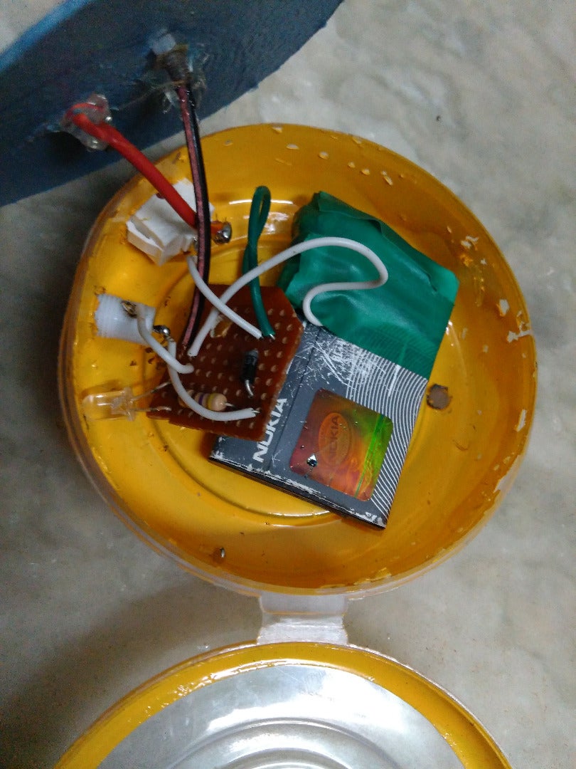

Step 5: Place Everything in Position
Now take flat PVC sheet & cut it in the size of bangle box then place the 3Watts LED on it for more details refer attached image.
then cut the flat PVC sheet as required size to fix the battery inside of box..

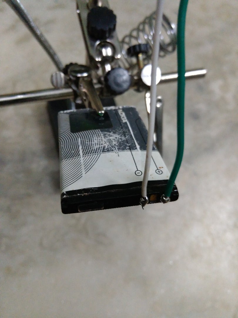

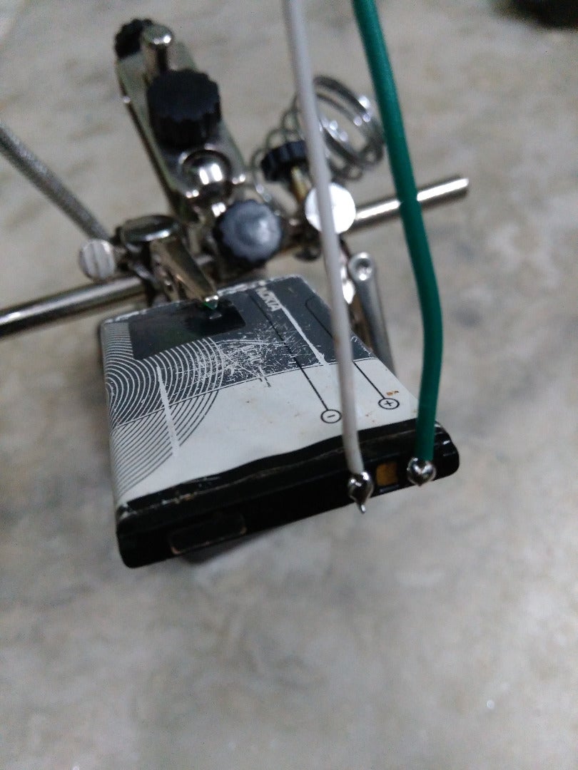

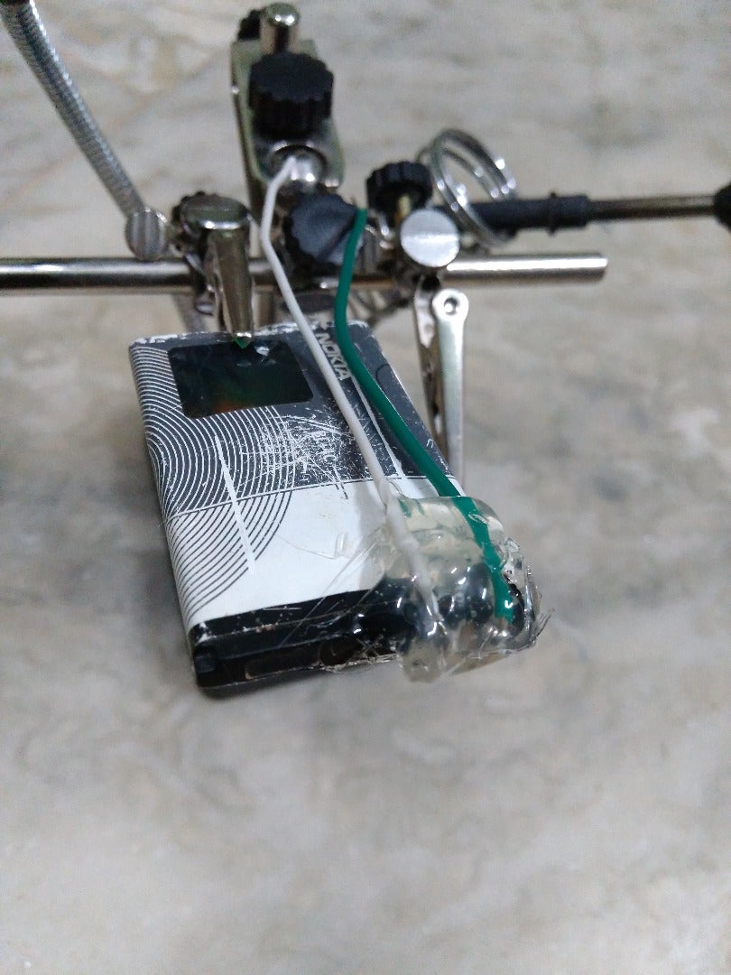

after that solder two wires on battery (+)&(-) terminals ..for safety purpose glue it and cover with insulation tape..
now give connection as per the circuit diagram..& place the LED sheet on top then screw it all
