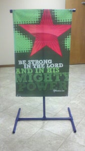

We had to create banner holders to hold banners for Vacation Bible School. The cheapest ones we found on the internet were about $70 each, so we had to find an alternative solution. We decided upon an "H" pattern of 1 inch diameter PVC for the base. In the middle of the "H" base, we put a "T" connector with a vertical 5 foot piece of 1 inch diameter PVC. The banner holder was attached to the top of this with a "T" connector and 1 inch PVC.

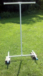

Using a hacksaw, cut 4 16 inch pieces of 1 inch diameter PVC
Cut 4 12 inch pieces of 1 inch diameter PVC
Cut 1 60 inch piece of 1 inch diamter PVC

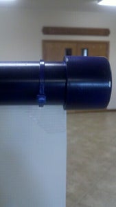

Assemble the pieces as indicated in the diagram. I only glued the PVC pieces on the non "T" part of the connectors for easy diassembly and storage. Put the end caps on the top horizontal end pieces of PVC.

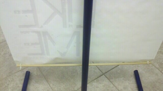

Once assembled, paint the PVC with plastic spray paint. Then hang the banner. I attached the top of the banner with electronic wire ties. I attached a 3/8 inch dowel with plastic wire ties to the bottom of the banner to allow gravity to keep the banner nice and taut.
