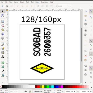

I've done some digging, and this is the process i've come up with, it probably could be streamlined and Inkscape can be cut out, but i like to use it for vector graphics :)
To prepare logo, I've used inkscape for that, as is free for vector graphics, but you can use whatever suits you :). Next fire up Paint, and set correct orientation on the picture, it has to be sideways (I've prepared picture sideways already in Inkscape) that part took me ages to figure it out....
(at this stage, I'm verifying if correct size is applied to the picture, and saving it as BMP256 color.

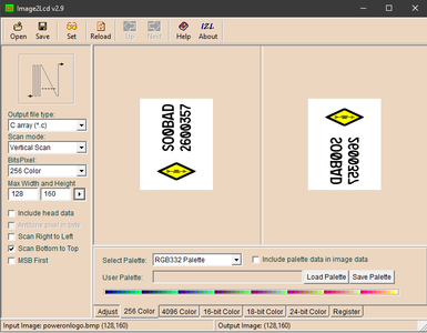

Now for all the tricky parts, fire up image2lcd load the picture and match the settings to tthe ones on the picture:
- output file: C-array,
- Scan mode: Vertical,
- BitsPixel - 256 color
- size set to 128/160
also mark "scan bottom to top"
in color area (botom) verify if in 256color tab, there is RGB332 selected from dropdown
If everything correctly set, your new logo should appear, flipped on the horizontal axis. hit save.

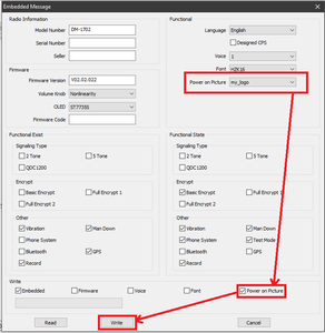

Once done, start the CPS software, and go to the "Embedded message" menu with code 374612,
note: if you do not know what the options are, do not touch them. And it'll be your fault if you'll break it.
If you did correctly everything so far, you'll have your file available from drop-down menu
labeled "Power on Picture"
(note: file has to be in the correct location BEFORE program starts) then all what's left is to mark
"Power on Picture" on the bottom for your earlier selected picture to be writen to the radio, and hit "WRITE".
Radio will power cycle and your new logo should be displayed :)
