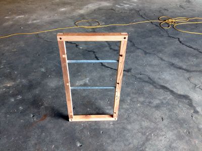

Use the angle grinder and a cut-off wheel to cut the pieces of conduit to the lengths described in the intro. Make sure to grind off any burrs to a nice bevel.
At the center of the back side of each rabbet, drill a counterbore with a 3/4" bit 3/8" deep. At the center of the counterbore, drill through with the 1/4" bit. Make sure to support underneath the rabbet with a sacrificial block to prevent blow-out from the drill bit.
Drill a 3/4"-deep hole with the 11/16" bit 2" above each of the two lower shelf dadoes (the ones starting at 18-1/2" and 29-1/4") and centered side-to-side.
For assembly, all of the parts kind of have to go together at once. Some clamps may help here. lay out all the parts as shown in the fourth picture. Coat the insides and shoulders of the rabbets with a thin, even layer of wood glue. Seat the conduit into the holes on one side of the frame, the the other. Put the 18" cross bars in place at the top and bottom and through-bolt each lap joint with a machine bolt, two washers, and a nut. Only finger-tighten everything first; check for square, then tighten down with a screw driver and a vise-grip. Measure out and pre-drill through the ends of each piece of conduit and secure with a screw.
On the bottom of the shorter leg assembly, add the casters. I had to add a wider poplar mounting strip to the bottom of mine in order to accommodate the width of the casters. This could be avoided with pin-type casters.
Once the glue dries, sand the faces of everything and ease the edges.
