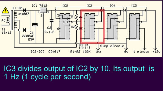

Step 3: IC2: 50-60Hz to 10 Hz Divider
Step 4: IC2 Line Frequency Selection
connect reset source signal according to your local line frequency
Step 5: IC3: 10Hz in to 1 Hz Out (divide by 10)

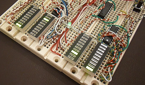

IC6-IC9: CD4017 cmos decade counter
Display: 4x 10 led bar-graph display
SW1-SW2 push-button momentary switch (time set)
Step 8: IC9: Minutes Units (0-9)
Step 9: IC8: Minutes Tens (0-5)
Step 10: IC7: Hours Units (0-9)
Step 11: IC6: Hours Tens (0-2)
Step 12: And Gate Decodes "24" and Resets IC6-IC7 to 0
Step 13: Seconds LED
Led LD1 blinks every second. Use SW1-SW2 to set time.
