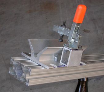

Step 4: Mount the Clamp on the Spacer
Cut a piece of the 1 x 1.5 aluminum tubing to the same width as the clamp. First, scribe a line 1/8" from the long edge. This way you can see if the mounting holes will clear the walls of the tubing when you drill through. Put the clamp on top of the spacer as shown. making sure the mounting holes clear the lines you scribed along the edge, and mark the mounting holes. Then drill and tap them to M5. I only used two bolts, on the diagonal, as you can see in the picture. Don't bolt on the clamp just yet.
Step 5: Prepare the V Block
First, we'll prepare the holes that will allow us to clamp the V-block to the main beam.
On the underside of the V-block you'll find a centerline built into the extrusion. Scribe a parallel line 3/4 inches on each side of the centerline. These two lines should match up to the T-slots on the extrusion. Then scribe two lines perpendicular to the centerline, one at 1 3/4 inches and the other at 3 1/4 inches from the short edge. At the intersection you've marked, centerpunch, drill, and tap to M8.
Now we'll add the holes to mount the clamp and spacer.
Scribe a line 0.4 (13/32) inches in from the long edge, parallel to the centerline, and then scribe two lines perpendicular at 2 and 3 inches from short edge. At these two intersections, drill through 5mm or 3/16", then countersink deep enough to fit your pan-head M5 screws to be slightly below flush.
Step 6: Finish the V-block and Clamp Assembly
Hold the spacer tubing in place on the V-block as depicted in the photos and mark the location of where the countersunk holes. Centerpunch, drill, and tap to M5.
Then bolt it all together.

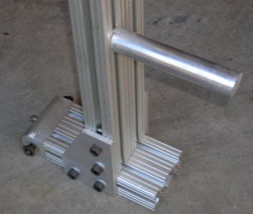

Step 7: Make the Park Stand Handle
This step will make the handle so that you can clamp the jig in a Park Stand, and then since it's round you can flip the fig over while you're brazing the fork. This can help when you're brazing a fork crown since it helps you with gravity when you're working on the steerer socket or the fork spigots.
Take your piece of round aluminum bar stock and drill and tap one end on center to M8. Then with a hand file, file a flat down on each side of the hole so that you are left with a ridge that will lock the handle into the T-slot. This keeps the handle from rotating and coming loose accidentally.

Step 9: Assemble the Jig
You can now bolt on the dummy axle portion. This should be self-explanatory from the pictures. Use a double T-nut on each section.
After you snug it together crank down the ones on the main beam, since they'll never need to be adjusted again.
