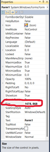

Now that we have opened our project, it is time to resize the form and change the background. Keep in mid that you are free to choose whatever form size or background you want, I am just demonstrating how it is done.
  1. To start, you can close out the the "Solution Explorer" tap in the top right corner if it is there. We only need the "Properties" tab as of right now. (Image 1)
  2. Now is time to change the size of the form. The size I used was 1678, 868. Choose whatever size best fits your desire for the game you want to make. To change the size, simply go to the properties tab on the right and select the "Size" property. The first number is the width (x value) and the second number is the height (y value), measured in pixels. (Image 2)

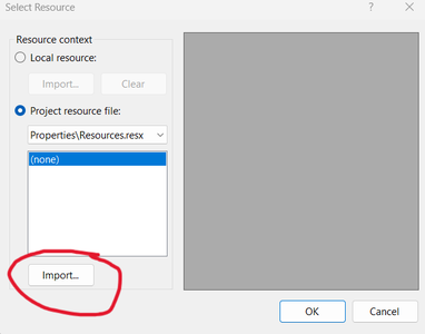

  3. To change the background image, click on the "Background Image" property also on the properties tab. (Image 3)
  4. A screen should pop up, select "Import" and then chose what image you would like from your files. (Image 4) *Keep in mind that the larger the file size of an image is, the slower the project will run.*
  5. To fit your image to the form size, click on the "Background Image Layout" property and change it to "Stretch". (Image 5)

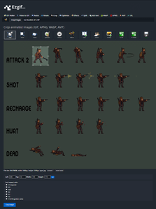

  5. Once one of the two sprite sheet images is uploaded, the tedious part begins. You must crop out every single one of the images on the sprite sheet. WHEN SAVING THE IMAGES, MAKE SURE TO NAME THEM IN PROPER ORDER. EX: WALK_1, WALK_2, WALK_3.... And so on. If not done this will result in much confusion later on. Also try to keep the size of the image you are cropping the same. Different size images can result in animation that is not smooth and very jittery.
  6. Repeat this process for every image on BOTH sprite sheets. Trust me, I know it is very tedious.

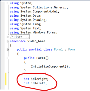

  1. Directly under public Form1() you will see two curly brackets containing InitializeComponent();. go directly under the bottom curly bracket and begin typing. You can see this code in (Image 2).This is where we will be making our variables. Start by typing the following:
int idleright;
int idleleft;
An int is short for integer, which is a whole number.

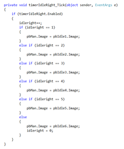

  5. Once you have changed the interval if each timer, double click on timerIdleRight. This should take you to your code tab and put you under the code for your timer. Now we are going to type the following code: (feel free to just copy and paste)
if (timerIdleRight.Enabled)
idleright++;
if (idleright == 1)
pbMan.Image = pbIdle1.Image;
else if (idleright == 2)
pbMan.Image = pbIdle2.Image;
else if (idleright == 3)
pbMan.Image = pbIdle3.Image;
else if (idleright == 4)
pbMan.Image = pbIdle4.Image;
else if (idleright == 5)
pbMan.Image = pbIdle5.Image;
else
pbMan.Image = pbIdle6.Image;
idleright = 0;
Once you have that written out (Image 4), lets take a second to explain what that means.
  1. So, we start with an if statement. So we are saying if timerIdleRightis enabled, then run the code beneath it. It is important to make sure that your curly brackets are in the right place as it can mess up your project.
  2. The idleright++; essentially means that we are adding to the variable idleright, every time the timer ticks.
  3. Now begins the nesting (putting an if statement inside of another if statement).
  4. The second if statement is saying that if idleright == 1then switch pbMan's image to pbIdle1.
  5. This cycle is repeated and idleright is reset at the end to make a continuous loop. (keep in mind that if you have a different number of idle sprites, just make sure to reset the value of idleright on the last image.)

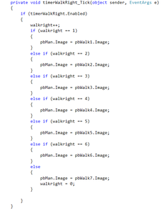

Go back to your designer tab now and double click on timerWalkRight.
Under this we are going to write the following code (can be seen in Image 1):
if (timerWalkRight.Enabled)
walkright++;
if (walkright == 1)
pbMan.Image = pbWalk1.Image;
else if (walkright == 2)
pbMan.Image = pbWalk2.Image;
else if (walkright == 3)
pbMan.Image = pbWalk3.Image;
else if (walkright == 4)
pbMan.Image = pbWalk4.Image;
else if (walkright == 5)
pbMan.Image = pbWalk5.Image;
else if (walkright == 6)
pbMan.Image = pbWalk6.Image;
else
pbMan.Image = pbWalk7.Image;
walkright = 0;

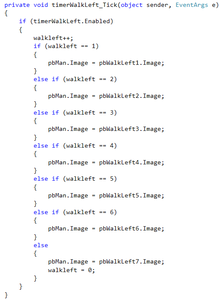

Now that we have the animation for walking right, lets double click on timerWalkLeft and copy the following code (can also be seen in image 2):
if (timerWalkLeft.Enabled)
walkleft++;
if (walkleft == 1)
pbMan.Image = pbWalkLeft1.Image;
else if (walkleft == 2)
pbMan.Image = pbWalkLeft2.Image;
else if (walkleft == 3)
pbMan.Image = pbWalkLeft3.Image;
else if (walkleft == 4)
pbMan.Image = pbWalkLeft4.Image;
else if (walkleft == 5)
pbMan.Image = pbWalkLeft5.Image;
else if (walkleft == 6)
pbMan.Image = pbWalkLeft6.Image;
else
pbMan.Image = pbWalkLeft7.Image;
walkleft = 0;

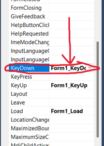

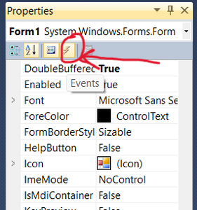

To start we are going to go the designer tab. Click anywhere on your form so that the properties for it appear on the properties tab.
Go to the top of the properties tab on the right and click on the small lightning bolt (image 1) which should show you a page called Events.
Once you see that, find the box that says KeyDown and double click on the empty box next to it. (image 2)
You should now be taken to your code page.

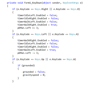

Copy the following code (can be seen in image 3):
if (e.KeyCode == Keys.Right || e.KeyCode == Keys.D)
timerIdleLeft.Enabled = false;
timerIdleRight.Enabled = false;
timerWalkLeft.Enabled = false;
timerWalkRight.Enabled = true;
pbMan.Left += 3;
if (e.KeyCode == Keys.Left || e.KeyCode == Keys.A)
timerWalkRight.Enabled = false;
timerWalkLeft.Enabled = true;
pbMan.Left -= 3;
What we're doing here is basically saying, if the right arrow key or D is pressed, then we move right, our right animation timer is enabled, and everything else is shut of. The same thing is done when we move left.

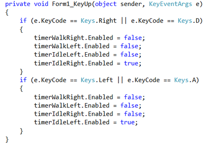

To polish this off we are going to go back into the form1 events that we went to earlier by clicking the lighting bolt.
Once on the events, double click on the empty box next to the box that says KeyUp. (Image 4)
This should again take you to a new line in your code where you will write the following: (Image 5)
timerIdleRight.Enabled = true;
timerIdleLeft.Enabled = true;
What this is doing is basically saying that if you are not pressing the buttons to go right or left, then your character will begin to idle in the direction that you were just facing.

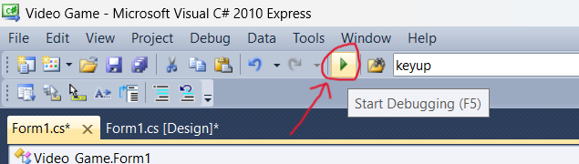

If you would like to run your game now, simply click on the green arrow in the top left of the screen. (Image 6) Try moving around in different directions and take note of the animation.
You can download and watch the attached video below to get an idea of where you should be.

Once you have your variables down, go to where you wrote the movement code under the KeyDown property. Right under that code you are going to write the following (Image 1):
if (e.KeyCode == Keys.Up || e.KeyCode == Keys.W)
if (grounded)
grounded = false;
gravityspeed = 0;

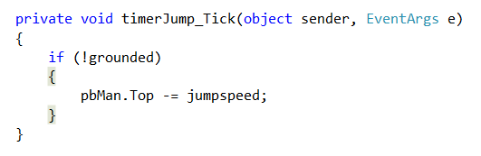

Now double click on timerJump and copy the following code (Image 3):
if (!grounded)
pbMan.Top -= jumpspeed;
Now you can double click on timerGravity where you will write the following code (Image 2):
if (!grounded)
gravityspeed++;
pbMan.Top += gravityspeed;
if (pbMan.Bounds.IntersectsWith(pbGround.Bounds))
grounded = true;
pbMan.Top = pbGround.Top - pbMan.Height;

This may be a little confusing and complex, so lets take a second to go over the code here.
  1. KeyCode code - This code is is saying that when the computer receives input that you are jumping, and you are touching the ground, it sets grounded to false (because you will be off the ground) and sets gravity speed to 0 because you are not yet falling.
  2. timerJump code - The "!" represents the opposite of what is written after it, so when we write "!grounded", it is a shorter way to write that we are not grounded. So this code under timerJump is telling the computer that if we are not touching the ground, then we ascend upward at the rate of our jump speed.
  3. timerGravity code - This code is again saying that as long as we are not touching the ground, our character will begin to fall at an increasing speed until he intersects, or collides with the ground. When we collide, it sets grounded equal to true.

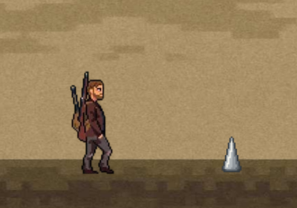

  1. To make something that your character has to jump over or avoid, we are going to start with making a timer. I named the timer timerSpike and set the interval to 1. Make sure that you set Enabled to true.
  2. After we have the timer, add a picture box onto your form. I named it pbSpike. Your picture could be anything. I set mine to a spike. Make sure that it is small enough for your character to jump over.

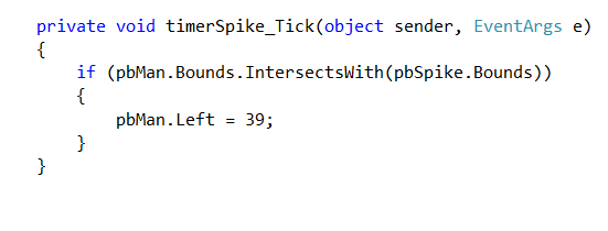

  3. Once you have your timer and picture box, double click on the timer and copy the following code beneath it. (see image 1)
if (pbMan.Bounds.IntersectsWith(pbSpike.Bounds))
pbMan.Left = 39;
This code is saying that if pbMan intersects with the spike, then his location will be set back to the beginning of the level.
*Keep in mind that locations will vary depending on the size that you chose for your form.*
