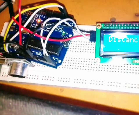

Now, let's imagine the chip doesn't have the bootloder (virgin chip). For that you have to make next connections from an Arduino UNO. These are the SPI pins, CLOCK, MISO and MOSI.
Step 3: Connect Arduino to PC
Now connect the Arduino to your PC. Open Arduino IDE and go to File → Examples → Arduino ISP and open that example. Select the com of the Arduino UNO board, select the board as Arduino UNO and uplaod this code.
Step 4: Bootloader
Now make the connections in the past schematic and is time to burn the bootloader. Go to Tools → programmer → Arduino as ISP. By that we change the programmer to ISP.
Step 5: Finally Burn Bootloader
Finally, go to Tools → Burn bootloader. Now the LEDs of the Arduino will blink a lot. Once you get the message of bootlaoder burned we are good to go.
