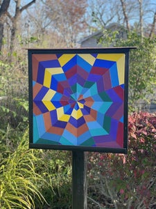

Introduction: Barn Quilt Holder
I start out with a half-inch thick piece of exterior grade plywood 26“ x 26“ cut trim as needed to fit around the edge. Bottom trim piece has a lip to support the 24 x 24“ barn quilt then I recessed a magnet using a bit, and a router and glue and nail it all together and top the piece off with a copper drip rail or you could use another piece of wood if you don’t have copper then mount to a 4 x 4 pole I used gorilla glue to glue a piece of steel to the back of the barn quilt, so the magnet can hold it on I start out with a half-inch thick piece of exterior grade plywood 26“ x 26“ cut trim as needed to fit around the edge. Bottom trim piece has a lip to support the 24 x 24“ barn quilt then I recessed a magnet using a bit, and a router and glue and nail it all together and top the piece off with a copper drip rail or you could use another piece of wood if you don’t have copper. Then mount to a 4 x 4 pole I used gorilla glue to glue a piece of steel to the back of the barn quilt, so the magnet can hold it on

Step 1: Measure Out the Plywood and Trim
1) Measure out the size of the base board. I used 1'2" plywood and the barn quilt is 24" x 24" so I cut the base board 26" x 26" to allow for the 1" trim.
2) Measure and cut the trim. I made my own L trim from some scrap pine trim boards.
3) Add a ledge to the bottom of the frame so you can use Barn Quilts that are made from thicker boards.
Step 2: Recess the Magnet
Use the router to make a recess in the plywood base so the magnet can fit flush. Super glue a piece of flat mettal to the back of the Barn Quilt.
Step 3: Glue and Nail Everything Together
Glue and nail the trim together.
Step 4: Add Rain Guard on the Top
I made this rain guard from some old copper flashing.
Step 5: Paint and Mount
I mounted the Barn Quilt holder to a 4x4 post using deck screws. Don't forget to check for level!
Done!
