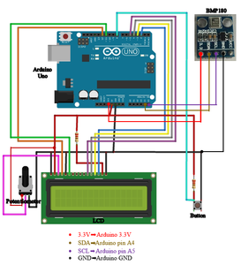

Step 3: Sample Hardware Installation

Step 5: Result (1)
The first measurement shown on LCD screen after the BMP180 does the sensing.
Step 6: Result (2)
The second measurement shown on the LCD screen after Button is being pressed for the first time.
Step 7: Result (3)
The third measurement shown on the LCD screen after the Button is being pressed for the second time.
Step 8: Result (4)
The fourth measurement shown on the LCD screen after the Button is being pressed for the third time.
