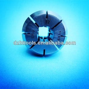

For one, you will need to use a collet chuck rather than a drill chuck to mount the tap, otherwise it will slip or rotate in place as you attempt to thread a hole.
For two, you will need a collet that has a square back end (called a rigid-tapping collet) or a collet that matches closely the shank diameter of the power tapping tool used, otherwise again, the tap would slip or rotate in place.
Good power tapping tools are pricey but they will pay off with the ease of threading and the quality of the threads they produce, I highly recommend getting a high-quality tap.
